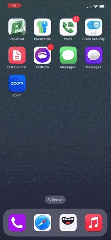

An alternative method, albeit one much more vulnerable to workarounds, is the ban the Camera app (com.apple.Camera) and anything else that takes pictures, but leave the camera itself accessible and have people run the hidden Code Scanner app, which can be found by a device/Siri search.
  • Jan 29, 2025 6:17 PM UTC
Thank you for the idea. I was able to make that workflow work in testing just now. My issue is that our users are not technical so something as simple as swiping down and typing "QR" is more than I would be able to educate the entire staff on. I was wanting to find a way to have the Apple QR app just sit on the home screen and just be one simple touch to open and use.

FYI apple does have a hidden native app called code scanner, pull down and search for it. Its there.

I am actively working on this issue and am not able to pin the app. I have however discovered that it can be added to the control center. But if you have a home screen layout it cannot be changed. So I just removed our HSL profile for when techs log into devices, they can re-add if its missing (I guess on ipads its not in the control center by default) When a tech logs off it re-applys the HSL config and users cannot edit.
