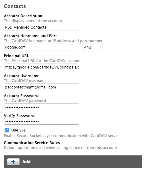

Hello!
This is very poorly documented, but I was able to figure it out using a Gmail account.
The Account hostname as follows:
https://google.com/carddav/v1/principals/psdcontactmgmt@gmail.com/
Replace the email address with the email containing your contacts. Port 443
NOTE: This does not work with SSO enabled on Google. I had to create a fresh gmail account specifically for this because SSO throws the error: CardDAV could not verify account
This error has been reported to Google and I have an active case open.
Once configured and deployed using a configuration profile, updating contacts happens within 2 minutes.
