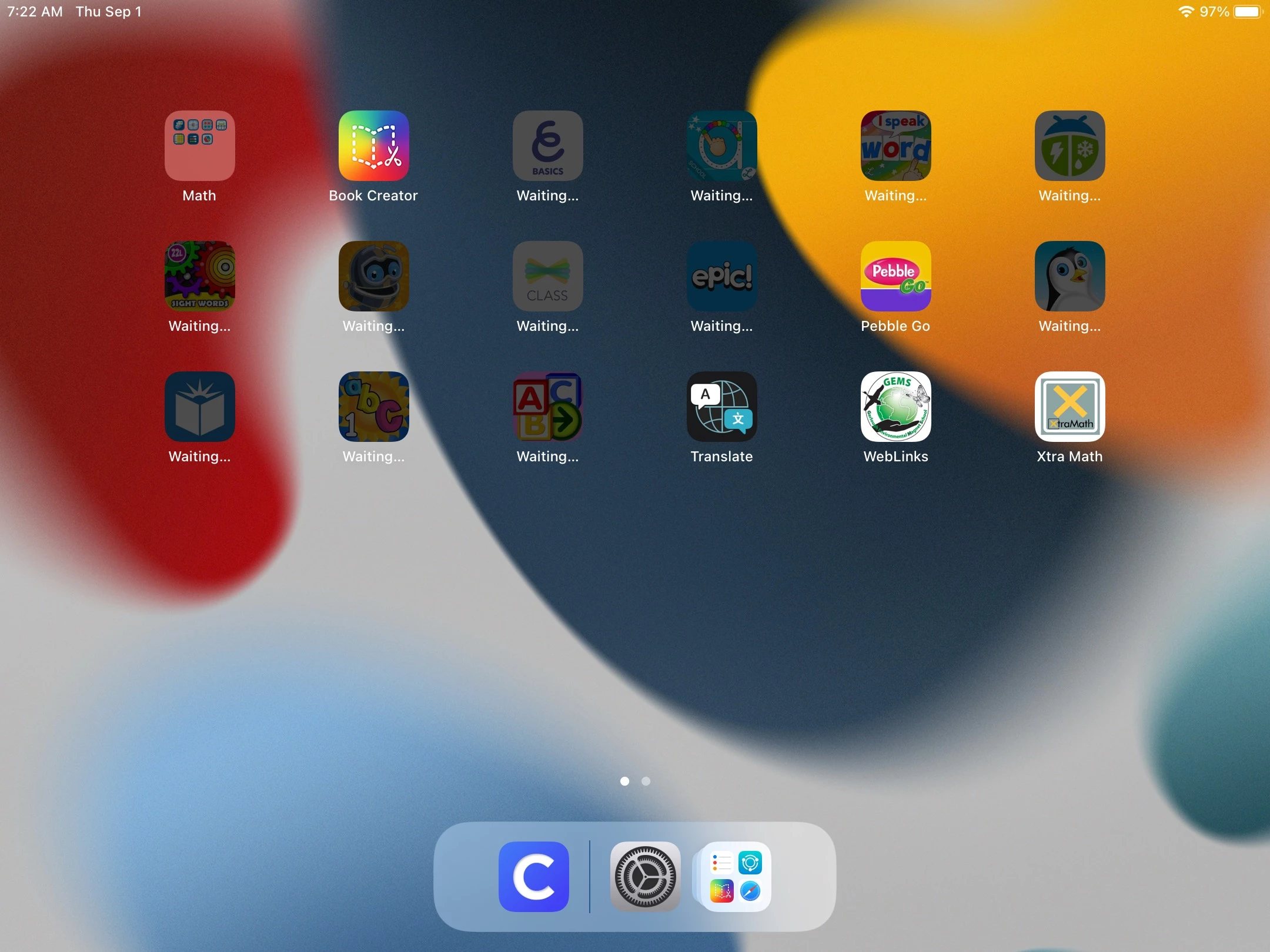

I am in this same situation with a few hundred iPads and I'm looking for a way to avoid a manual one-by-one fix.
Brand new Gen 9 iPads, plenty of storage space, apps with the "waiting..." differ from iPad to iPad.
I've tried:
  • Updating iOS (to the latest at this time of posting 15.6.1)
  • Restarting iPads
  • Send blank pushes
  • Excluding them from some of our configuration profiles that set homescreens, blocks app store use, and prevents users from deleting apps.
I've tried:
  • Restarting iPads
  • Send blank pushes
