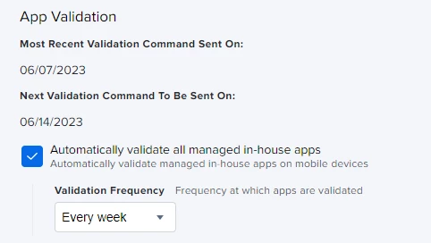

Best answer by bootrec
I believe what you're seeing is caused by this setting:
Outlook and other provisioned apps on my iPhone shows it's been re-installed every week, same version number, due to this setting.
Settings > Device management > App maintenance > In-House Apps

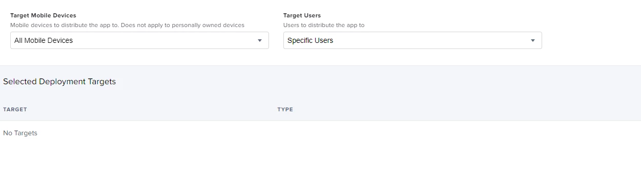

Thanks for the reply. Please be patient as I am just taking over some duties in this role. I just pulled up an example of Microsoft OneDrive and see this on the scope section:
  • May 31, 2023 5:41 PM UTC
I just noticed in that image I posted that the users say specific users but there are no targets. Seems like that should be all users instead since this is a standard organization wide app. Could that be causing the issue?
It shouldn't be causing the issue. Honestly, I can't think of a reason why this would happen unless it's something being glitchy with the App Store. Are there also profiles that are getting reinstalled? If it's possible to reboot this Jamf Pro server (if it's not Jamf Cloud), you could try that.

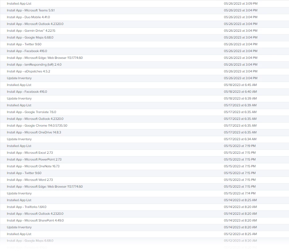

Yeah they are all in Mobile Device Apps from the ABM/App Store. Here is a screenshot of a device that shows multiple installs of multiple apps over a 2 week period:

I copy what you're saying but I've had at least a couple folks say that during those times, the app icons blur like they are in fact installing and the apps are unusable.
mvu
  • Jun 1, 2023 9:57 PM UTC
Looks the same as mine. For some reason, Jamf always lists the latest version for every app over and over. If you check again later, when Outlook releases an update, it will show just the latest version over and over.
I see the same.
When the App icon blurs and installing, it's actually updating to the latest version. The updates sit as pending until the user unlocks the device. Then the updates roll down all at once.
Do you have this checked off?
"Schedule Jamf Pro to automatically check the App Store for app updates Automatically update app description, icon, and version in Jamf Pro"
This is normal, JAMF just shows the current application name in the history. They were just updated because a newer version was released on the app store, which happens when the device is unlocked and an update inventory is run. You root issue here is your Karen users. :P

  • Jun 9, 2023 10:06 PM UTC

  • Dec 5, 2023 10:28 PM UTC
I don't know what the full impact is of disabling that setting so I just extended the time period out to 8 weeks.
