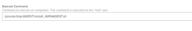

Hello All,
I have followed this guide exactly and am going crazy. https://docs.arcticwolf.com/agent/installing_mac.html
The error I am seeing seems to be related to the "Execute Command" section or perhaps the .sh script itself  This is what the details from the log shows:
Result of command:
/private/tmp/AGENT/install_AWNAGENT.sh: line 1: {rtf1ansiansicpg1252cocoartf2709: command not found /private/tmp/AGENT/install_AWNAGENT.sh: line 2: syntax error near unexpected token `}' /private/tmp/AGENT/install_AWNAGENT.sh: line 2: `\\cocoatextscaling0\\cocoaplatform0{\\fonttbl\\f0\\fnil\\fcharset0 Monaco;}'

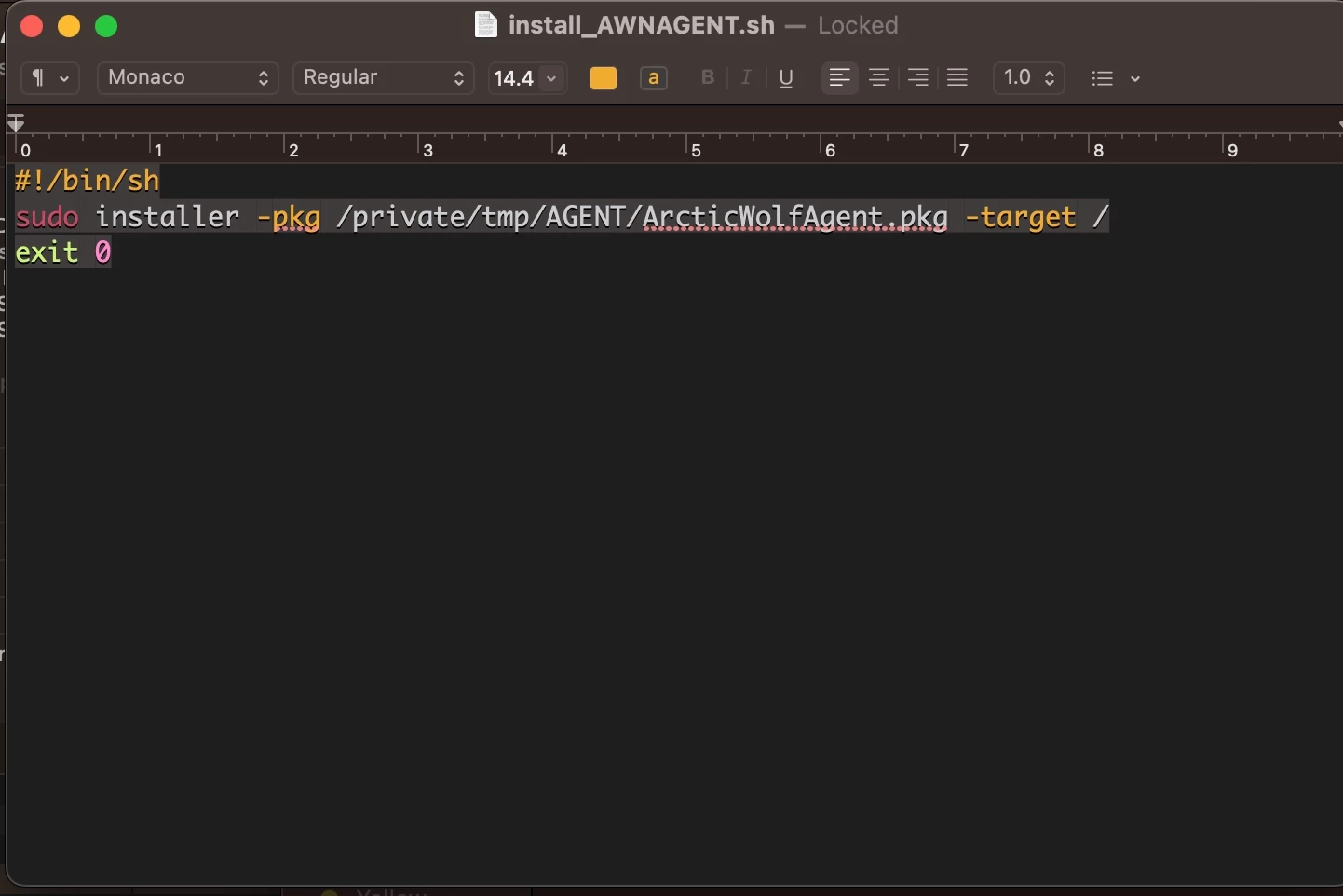

I've tried my best to confirm that the .sh is created properly, the file shows SHELL on the Icon and its definitely a plain text document
Any insight would be extremely helpful.  Also one thing to note is when I copy pasted the command from the .sh file and ran it in terminal it prompted for my password and then installed
Thanks

@hustler, your script is also not a plain text file. It looks to have some additional text that is confusing things.
Best to use CodeRunner or similar script editor to eliminate that issue.
