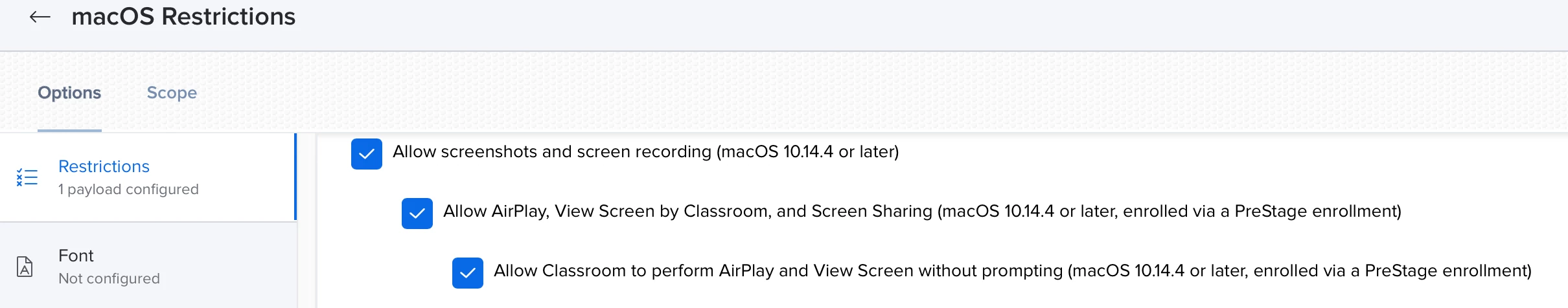

@Bol Thanks for suggesting enabling the three Restrictions for Screenshots, Airplay and Classroom. Unfortunately enabling these had no effect.

Because of Apple's changes, you now need to use MDM / Jamf to do this.
Either press the 'Enable Remote Desktop' button on the computer object in Jamf or you can script the same outcome by using the API (there's scripts on the forums you can try).
