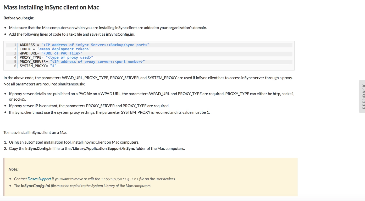

I need some assistance in getting Druva (inSync client) deployed to All Mac OS(X) in our environment. I've already created the inSyncConfig.ini text file: https://docs.druva.com/003_inSync_Enterprise/5.3/020_Administrator_Guide/040_Managing_users_devices_and_inSync_client_installations/040_Mass_deploying_inSync_client_on_user_devices not sure how to deploy via Casper Suite/JAMF Pro on Cloud Hosted JSS. We have a Dev Hosted JSS which I will be testing on. Do I just use Composer to create a .pkg of the inSyncConfig.ini and then create a script because according to Druva documentation: Copy the inSyncConfig.ini file to the /Library/Application Support/inSync folder of the Mac computers. Or do I have to create the Directory first prior to script. I couldn't find any "Easy" button. jk Thanks for any assistance on this.

There are a couple ways you could go about doing this. You could write a bash script to grab the file off of your jss and place it where needed, or you could use composer to create a package that does essentially the same thing.
Feel Free to Remove the variables. I'm Not 100% on if it'll work with them that way

Or you could simply create a package with composer that installs it into /Library/Application Support/inSync.
You might want to add a preinstall script that creates /Library/Application Support/inSync if it isn't already there, although I don't work with composer enough to know if it will just create the directory for you or not.
