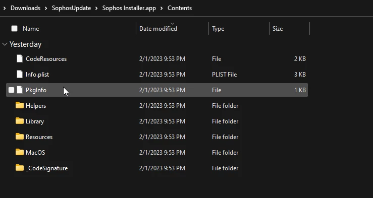

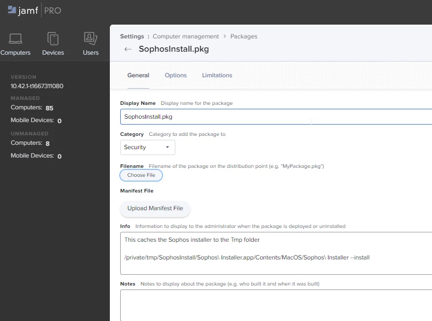

Hello,
We have an older version of Sophos in our install package which will not install for any device running M1 or M2 chipsets.  This has been patched by Sophos but I need to get our current Sophos installer updated.  After some research I determined this will be a two step process.  One step is targeting the 27 enrolled devices are are missing Sophos through a configuration profile and a Static Computer Group.  And the second portion is updating the install .pkg.  When I follow the directions from Sophos it says click the 'Filename' file that is a .pkg file and upload, and then do the same with a Manifest File.  After downloading the macOS Sophos installer it is 3 file folders and the only .pkg file in any of these folders or sub-folders is a file called InfoPkg.Pkg.  Am I supposed to just rename this to something like "SophosInstall.pkg" and upload as Filename?!  And should the manifest file be a .plist extension?

There is a Script from Sophos included, we use this always... works like a charm and you don´t have to package files...
  • Feb 3, 2023 1:27 PM UTC
How do you get your sophos installs, and do you use the cloud product? Sophos have moved away from packaging the client and to a scripted download like mickl089 said
Installing Endpoint Protection using Jamf Pro - Sophos Central Admin
