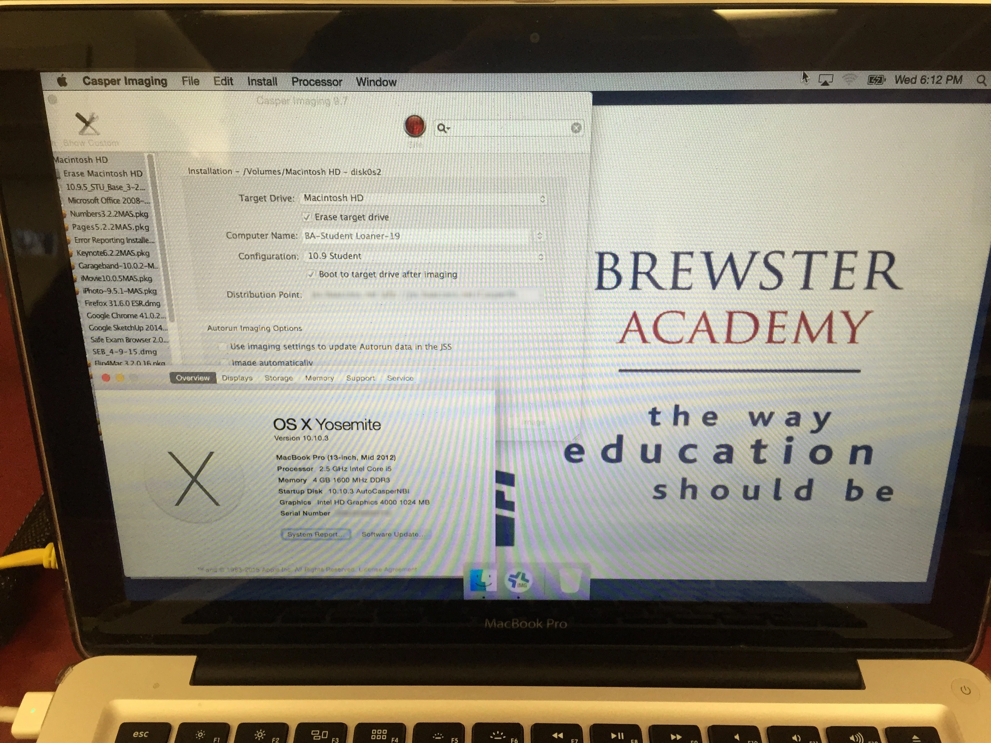

SWEET! 10.10.3, 9.7 AutoCasperNBI is live at Brewster!
So, yep. Up and running super quickly thanks to @bentoms I'll say it again over and over. Creating custom NBIs are pretty damned easy. Yet, I almost don't even care anymore given that the process is pretty much fire and forget with AutoCasperNBI.
I have tested a clean distro 10.10.3 with recovery partition just fine. However, we're still primarily running 10.9.x for the remainder of the school year so that's what you're seeing here. One thing though Ben, any way to get AutoCasperNBI to remember the last index number used and automatically offer the next in succession? Don't remember if this was asked before.

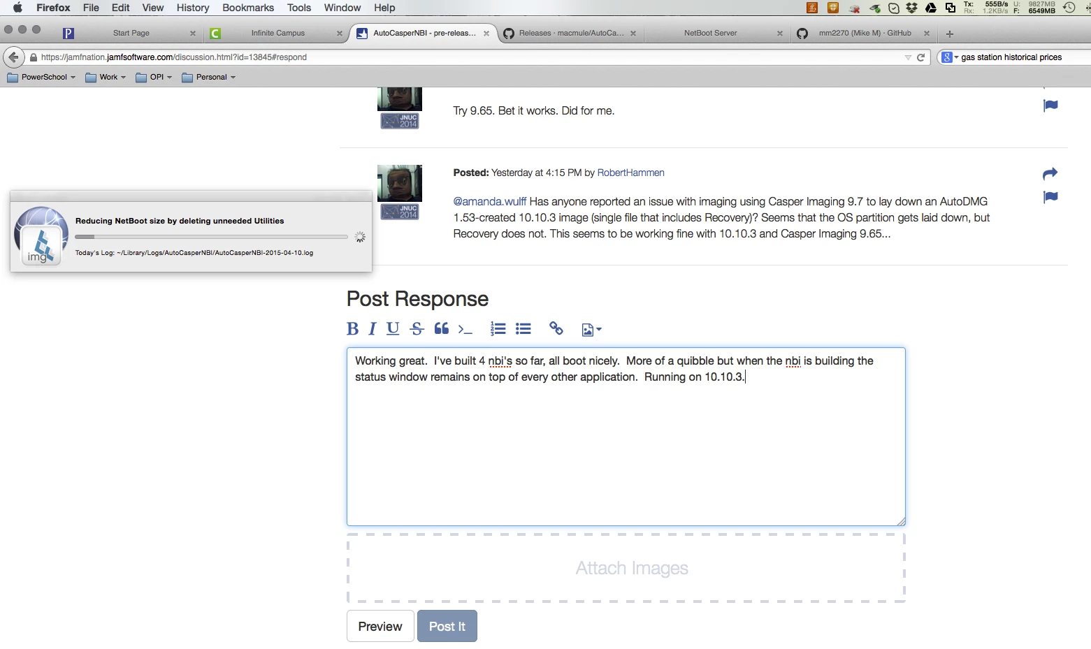

  • April 10, 2015
Working great. I've built 4 nbi's so far, all boot nicely. More of a quibble but when the nbi is building the status window remains on top of every other application. Running on 10.10.3.

  • April 10, 2015
@johnnasset It's the fun of the language I wrote it in, basically as it's not a multithreaded language.. if I make the progress bar hide.. you can't bring it to the front until the process ends & in the dock all you see is it not responding.
