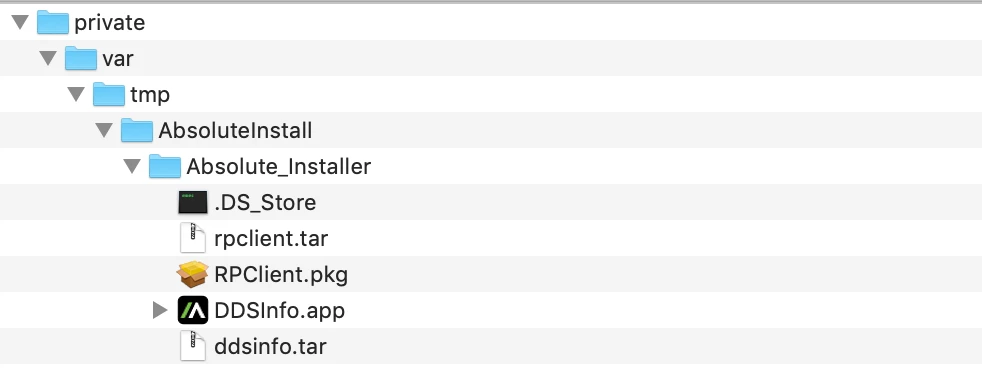

I don't know if your installer is the same one that I had, but this is what my install looks like.
On my machine, I created a temporary folder in the directories listed in the screenshot above and placed the files associated with the Absolute RPCclient.pkg. Then, in a postinstall script, I executed the following:
## postinstall
installer -store -pkg /private/var/tmp/AbsoluteInstall/Absolute_Installer/RPClient.pkg -target /
rm -rf /private/var/tmp/AbsoluteInstall
I did not have to launch the DDSinfo tool to get them to communicate with the Absolute console after this.

@SlidewaysF30 Humm interesting! You didn't need to run the DDSInfo.app? Why did you put it in the Absolute_Installer folder then? When you run the RPClient like this does it register properly with a unique identifier on the DDS admin page online?
  • January 23, 2020
I left it there for testing purposes so I can verify on the machine whether it successfully phones home. Unfortunately, I do not have access to the Absolute Admin console as that is managed by our security team, but I verified with them that our devices were registering properly and communicating. So far, I haven't heard any issues from them regarding the UID.
