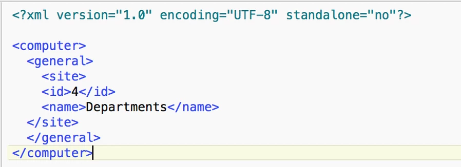

szultzie
  • August 24, 2018
Here is a screenshot of the actualy XML file
szultzie
  • August 24, 2018
ok so its working now, i recreated the xml file using TextWrangler and the scrip file. And confirmed my username and password and it works with my . full admin, now trying to figure out what minimal access i would need to create a user with rights just to do this
Thanks for your help.

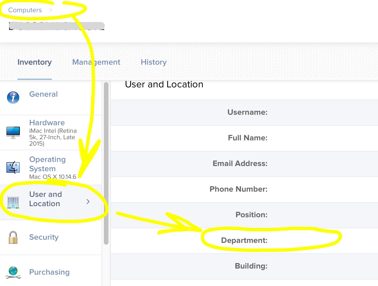

  • December 27, 2019
Another step...
Would you please show me the right direction to use API for changing that computer assignment part:
Computers - Users and Locations - Department
Thanks!
