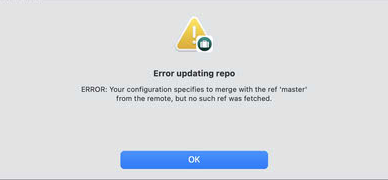

Thank you for the info.  I first removed all of my local over rides and was not able to create a new over ride. I did forget the error but said something about deprecation. So I moved to uninstalling Jamf Importer. I then attempted to install Jamf Uploader as you suggested and was presented with the error attached.

I think you should go right back to basics.
On the command line, can you build a package from a recipe? If not, you need to figure out why and fix that. Then you need to see if you can create an override, if not why not? Fix that.
Then you can try and get JamfUploader working from the command line.
Once you have all that running you might be able to integrate it all with Autopkgr, until then Autopkgr will just get in the way. Autopkgr doesn't make it easier to get all the things working, it just hides details.
