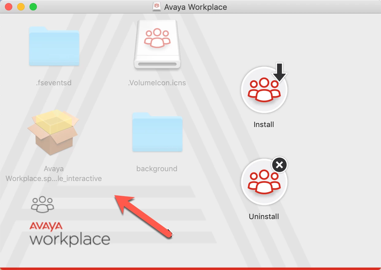

FerPeteSake why do they hide the pkg?
I have been struggling with this myself, and want to share my finding. I could not locate the Avaya IX Workplace.sparkle_interactive.pkg from previous posts.
It turns out the (most important and useful) .pkg file is just a hidden file on the mounted volume that contains the installer.
To show the hidden files, command+shift+. will do it.
Copy those three files Install.app, Uninstall.app, and (in this version) Avaya Workplace.sparkle_interactive.pkg to your temporary folder.

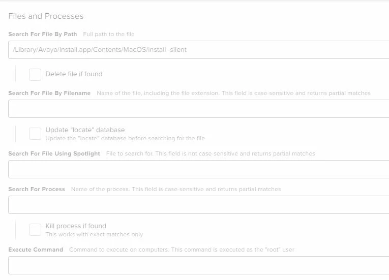

I set my policy to install the package that puts the files in place, then I end with a Processes command at the end.
/path/to/your/tmp/AvayaWorkplace/Install.app/Contents/MacOS/install -silent
That way, I am running the full vendor script with its logic that roots out old versions and deals with them, if they exist.

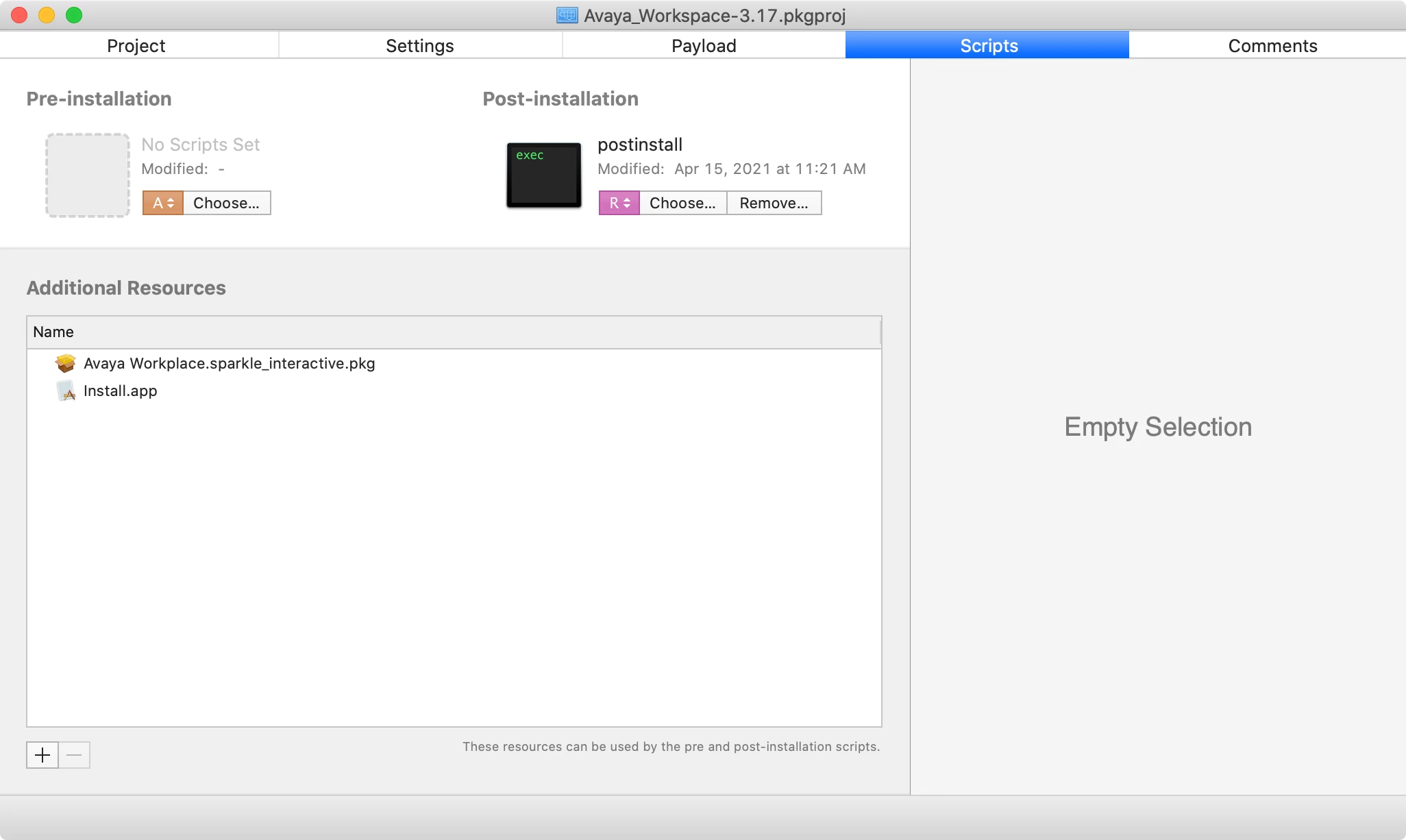

Example of how to build a package using Packages.app
The postinstall script. The script includes optional commands that record details to a log file: CompanyNameInfoTech.log
# Variables used for logging
logFile="/private/var/log/CompanyNameInfoTech.log"
# Logging funtion
log () {
    echo $1
    echo $(date "+%Y-%m-%d %H:%M:%S: ") $1 >> $logFile
log "-----"
log "Begin install Avaya Workspace 3.17.0"
# Determine working directory
install_dir=`dirname $0`
# Change to working directory
/usr/bin/cd $install_dir
# Install the FireEye HX agent
$install_dir/Install.app/Contents/MacOS/install -silent
log "Completed Avaya Workspace install"
exit 0  ## Success
exit 1  ## Failure

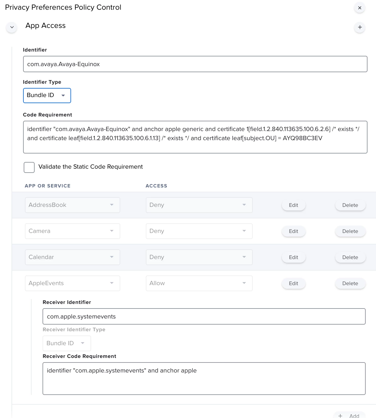

Here is the PPPC configuration profile that works for us.
Notes: 1. We do not use the video conf feature - so no reason to allow camera.
2. I believe you can deny microphone, but a configuration profile can't "allow" it. It's still up to the user.
3. The access to contacts and calendar are for the Apple Address Book app and Apple Calendar app. Since we use Outlook, I have set those to deny.

Not sure if anyone is still looking at this thread, but I did what @jhalvorson did above in packages and get the below install errors from jamf:
Installation failed. The installer reported: installer: Package name is Avaya.3.18
installer: Installing at base path /
installer: The install failed. (The Installer encountered an error that caused the installation to fail. Contact the software manufacturer for assistance. An error occurred while running scripts from the package “Avaya.3.18.pkg”.)
Any Ideas?
Forum|alt.badge.img+27
  • Jun 10, 2021 1:03 PM UTC
@john.massa Before you added the "postinstall" script to Packages, did you run the command to make the file executable?
Typically I use this command on the file:
sudo chmod u+x /path_to/postinstall
The install.log on the device may explain what failed. (The path is /private/var/log/install.log)
If you are new to Packages, I recommend checking out @rtrouton site for hints and tips https://derflounder.wordpress.com/2016/01/14/creating-an-office-2016-15-18-0-installer/
  • Jun 10, 2021 2:52 PM UTC
@jhalvorson Thank you! I've made a half dozen other packages using Packages and never had to change perms, but that seemed to do the trick! Thank you again!

@jhalvorson May I ask where/how you found the Code Requirement for the PPPC ?
  • Jun 10, 2021 4:24 PM UTC
@john.massa I used the PPPC Utility by Jamf - https://github.com/jamf/PPPC-Utility.
When you drop an application into the PPPC Utility, it will display the Identifier and Code Requirements. With that information, I created the Configuration Profile within the Jamf web console. I didn't save or export it from PPPC Utility. Times when I do save the configuration created by PPPC Utility, it's used as a learning aid and I compare what is build by Jamf Pro.
The addition of the AppleEvents Allow was based on other people's posts.

i followed @chris.hansen steps and was able to install with no issues, but when i add the -silent -autoconfigURL https://baseurl:411/workplace.txt command after the install command as mentioned by @gwertman , it reveals my hidden jamf management account user folder to the following path /jamfmgmt /library/application support/com.avaya.Avaya-IX-Worplace/installlParameters.plist. has anyone come across this issue and figure out a way around it?
