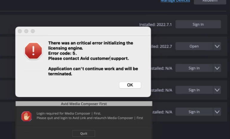

I am trying to install and license Avid Media Composer on lab machines using floating license.
Used Jamf composer to install the pkg for Avid Link first and then Avid Media composer with postinstall script
installer -pkg /“installer.pkg” -target /    the app install fine.
I tried to capture the license using another package.
But getting error when opening Avid Link
anyone knows how to capture the license?

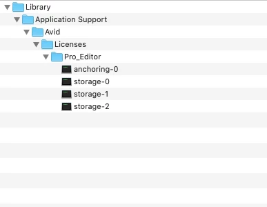

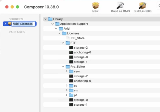

We are using an Avid Floating license server and the following Composer capture works for us.
As for the installation... We use Avid's Media Composer Package installer (Set at 10 Priority), iLok's Package installer (Set at 11 Priority), and the Floating License installer below (Set at 12 Priority)
We have been using this method for a few years now...
Hope this helps.
Hope this helps.
Do you capture the license as a pkg or dmg?
  • Sep 6, 2022 8:01 PM UTC
We capture it as a pkg.

I am also having the same problem now with Media Composer Ultimate 2023.3. I used to use the same files shown below by rroueau in Media Composer 2022, but now it no longer works with 2023.3.
