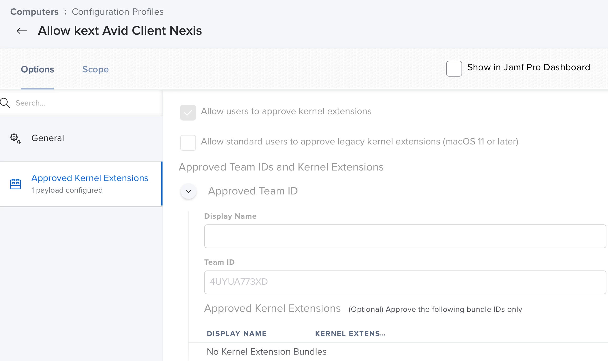

Does anyone here have any experience in the distribution of Avid NEXIS Client Manager using Jamf Pro? Distributing the package is no problem but after the application launches it immediately closes again. Probably because of some PPPC settings but i can't seem to find which one.

Hi, I don't know if you solved the problem, but this is the PPC setup for the Avid Nexis Client. Please note: deploy the PPC configuration profile before distributing the pkg. After that, the standard user will be able to allowed it from the system preferences. There is no way to automate this process. Best, ⁣
