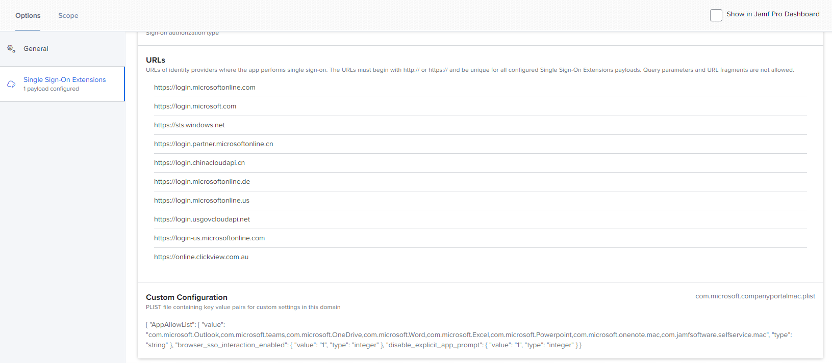

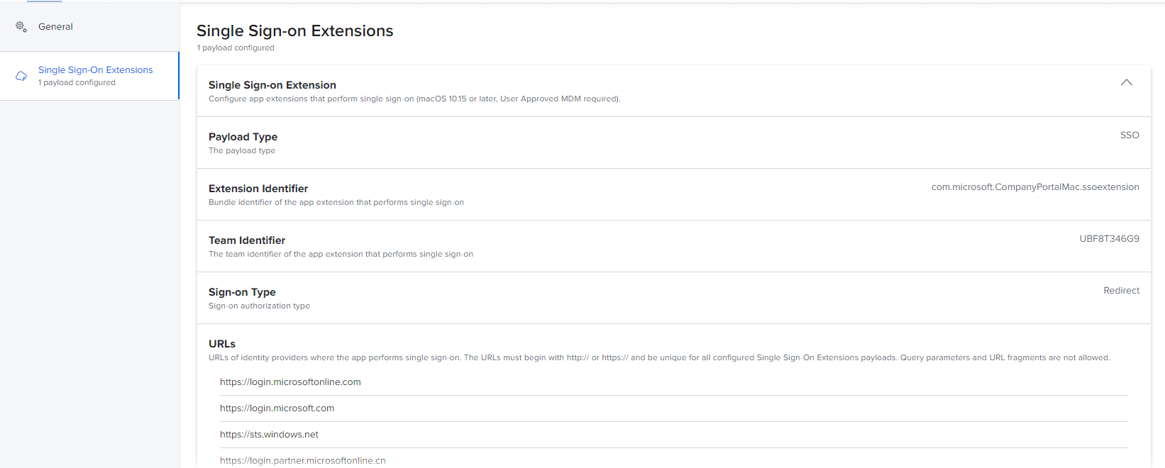

I have attached images of my config profile setup
  • Apr 27, 2021 1:02 PM UTC
hobbs155, I do have the Azure SSO profile working without using conditional access. All I am doing is deploying my profile alongside the Intune company portal and that seems to be doing the job. Your profile appears to match mine.

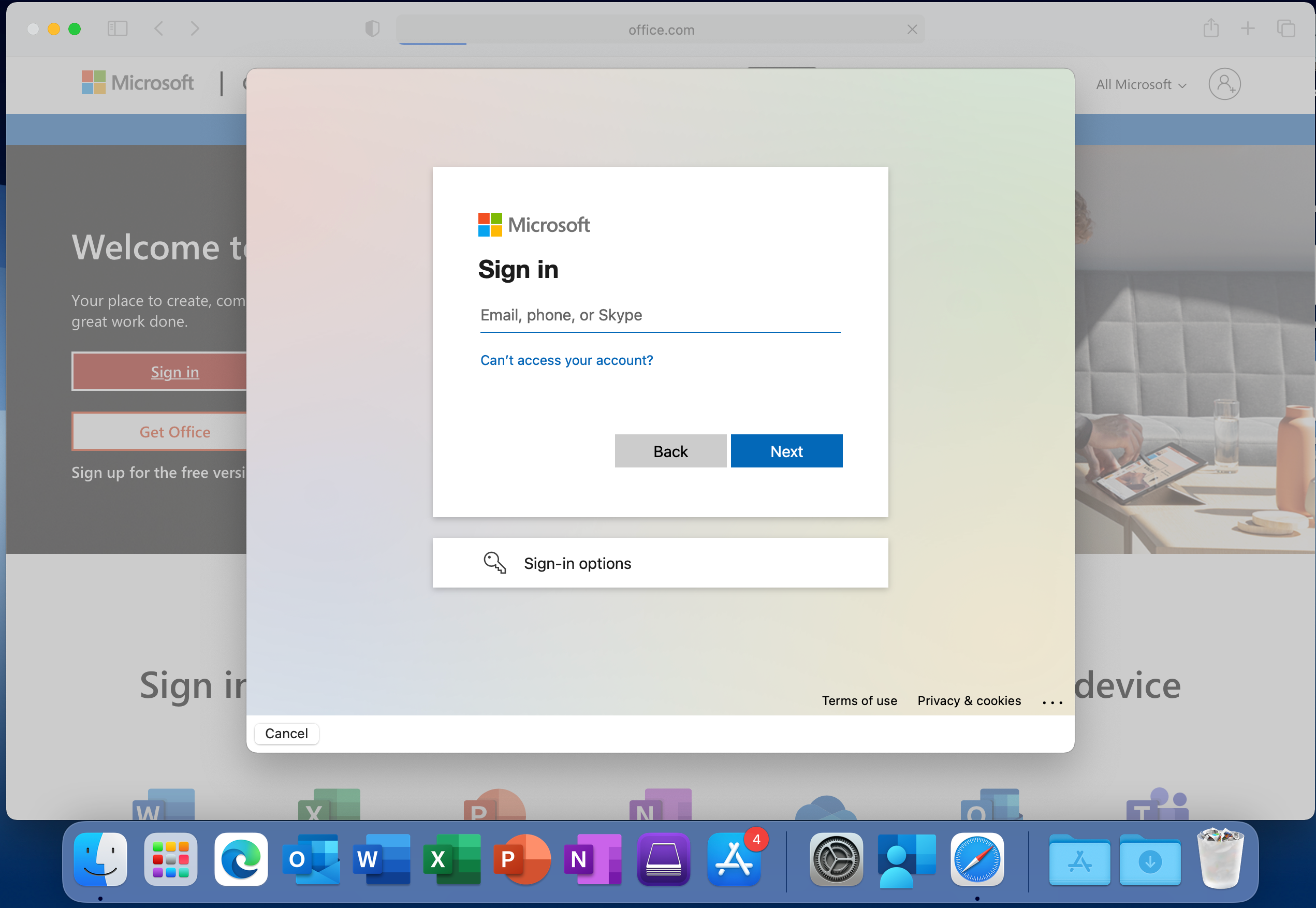

This is what i see when trying to log in to office.com via safari.
  • Apr 28, 2021 1:15 PM UTC
That screenshot looks good, you have to login at least once and that popup window is the company portal doing the brokerage between safari and Azure, once you login the company portal should pass the token to each other app that needs to authenticate.
