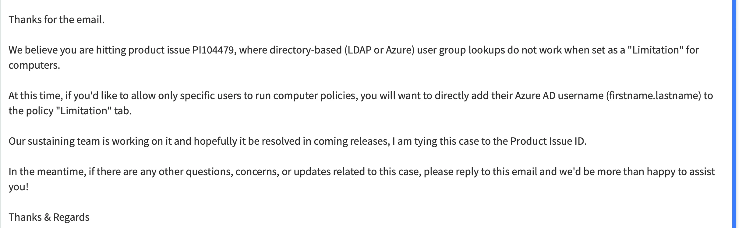

MacJunior
  • Sep 16, 2023 9:11 AM UTC
I opened up a ticket with Jamf and after taking back and forth this was their last reply :
