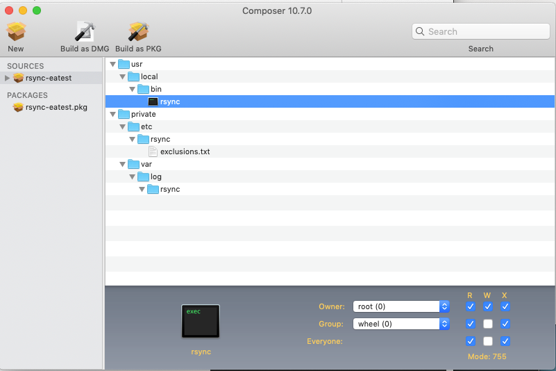

As it might be a permission thing, here is the payload of the rsync 3.1.3 package I created within composer:
