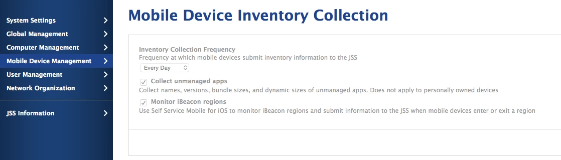

I tried beacons with the example of JAMF's video (deploy Web Clip).
I tried limitation/exclusion option, nothing works :
- limitation : no Web Clip appears
- exclusion : no Web Clip disappear
Other question : why is it not possible to use Beacons to scope App deployment ?
Best answer by Antoine_Moussy
It works now. I just forgot to tick "Monitor iBeacons regions" in Mobile Device Management / Inventory Collection.
Thanks to Thomas from Jamf France.

As mentioned above, beacons have to be defined within the JSS and the Inventory Collection option listed above should be checked for both OSX and iOS.
Then on the next check-in for computers the list of beacons to watch for is downloaded to a local plist, /Library/Application Support/JAMF/Config/iBeacons/monitoredBeacons.plist, and the /Library/LaunchDaemons/com.jamfsoftware.jamf.daemon.plist is modified to watch for entering or leaving beacon ranges and then tells the JSS that the event happened. If you plan to use it as a trigger for a policy you have to define a custom trigger, 'beaconStateChange'. For profiles it should kick off via APN when the daemon tells the JSS.
On iOS the Self Service app has to be opened after the Beacons are defined so the list is downloaded to the device.
And the above mentioned defect relates to being displayed within Self Service. Leaving a beacon range may take longer than you expect for it to tell the JSS you left but that should work.
