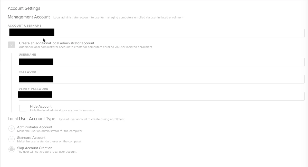

@boberito Not scripting it for this particular account though we do for other. I've included a pic from one of our DEP setups that shows where we create the additional account.
And your createmobileaccount call might look like the following.
/System/Library/CoreServices/ManagedClient.app/Contents/Resources/createmobileaccount -n [ADUSERNAME] -a [SecureTokenAdminName] -U [SecureTokenAdminPassword]

So I've tried that where I create an additional account and I've seen the additional account not get a secure token.

@boberito @aporlebeke we are wiping our drives and installing 10.13.4 (all SSD so should be all APFS) and skipping all steps in set up assistant and have our prestage creating an admin user (NOT hidden) and that admin user appears to get secure token fine.
On slack someone else was trying to hide admin user and was having issues. Not sure if you all have tried not hiding admin user, or if that's an option for you.

@boberito my prestage matches the screenshot that @andrew.nicholas posted above. sorry if that's not helpful. weird it would work for us and not you? I am testing with 10.13.4 though, not with the supplemental update.. was holding off on rebuilding my installer until 10.13.5 was released.. I should probably test with supplemental just in case asap.

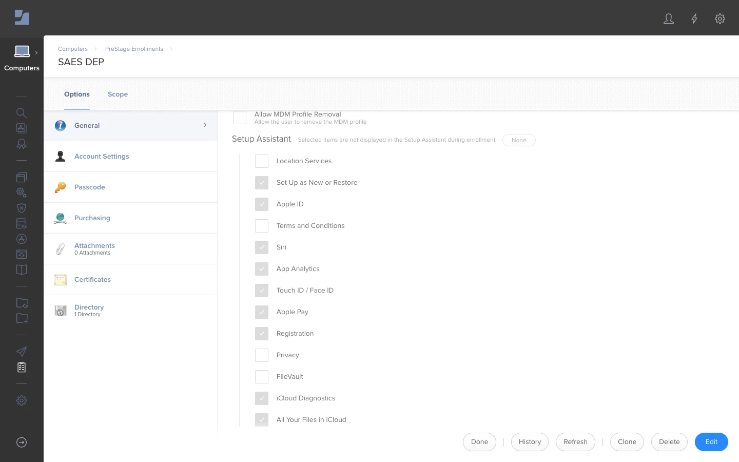

This sounds silly but since I've tried that where I create an additional admin account and it doesn't work.
What's checked or unchecked in your Prestage enrollment --> General --> Setup Assistant.
I wonder if that may have something to do with it?
  • May 7, 2018 2:39 PM UTC
@boberito i check everything. jss 10.4 but was working same in 10.2.1. Filevault is no longer an option to check or uncheck in 10.4

Weird. I'll try checking everything.
