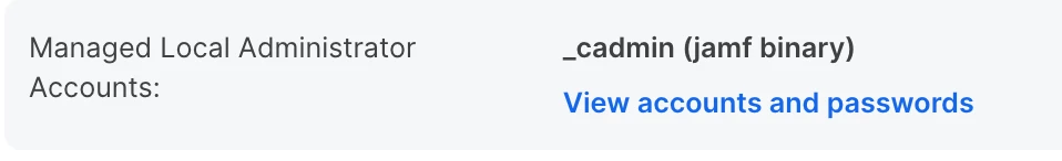

In Jamf Pro, there is already a local administrator account called _cadmin
Go to:
Jamf Pro → Computers → Search Inventory → Your Device → Inventory → General → Managed Local Administrator
You can use this account , the password is automatically generated with a strong complexity and is valid for 1 hour.

So what do you do when you are working on a machine and you need to restart. Do you just run the terminal command to bypass file vault everytime?
The problem with the managed local admin account is that the password change doesn’t appear to change the password for file vault. At least that has been my experience.
