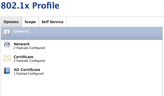

This can be very tricky.. took us a lot of time to get this to work. We fixed this with a configuration profile with different payloads which have to be created in the correct order.
You need the Certificate Payload to put the needed certificates for the RADIUS inside the profile. Then you need the AD Certificate Payload where you enter the exact address of the RADIUS, the name of the certificate authority, and so on.
Now you can go the to third payload, Network. Here is the part where everything comes together. If you want to use the authentication for WiFi and Ethernet you have to use the little plus-symbol in the upper right corner to set up settings for WiFi and separate for Ethernet. Choose the protocol, enter the username which is expected from the individual computer certificate. For example "%ComputerName"$@domain-name.com" With the %ComputerName% you make sure it always takes the individual name of the client. As Identity certificate choose the AD certificate, which was set up with the AD Certificate payload before. When you are done, click on the "Trust" button and activate each certificate, which were set up with the certificate payload before. "Trusted Server Certificate Names" should be the whole domain. Like " *.domainname.com"
