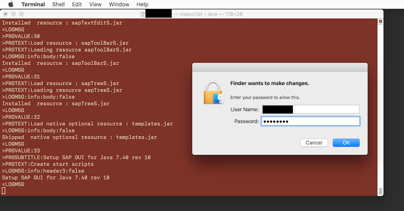

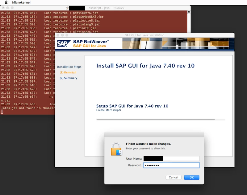

Curious if you're putting the sapgui.registry into /Library/Preferences/SAP/ or if you're putting that into each users' home directory as well?
Tried several variations of their install command, including using --elevated (which seems to imply won't need any interation), and/or using --slaveprocess (which is kind of vague), such as:
$ sudo java -jar /path/to/PlatinGUI740_10-XXXXXXXX.JAR install --force --nodesktopicons --register --slaveprocess --standard --elevated --logfile "/var/log/sapgui.log" --installdir "/Applications/SAP Clients"
But the command won't work unless someone is logged in...AND...unless that person or someone else is able to authenticate the dialog box that comes up. Not very silent even though invoked using sudo.
Here is their command line help, unfortunately no examples of how to deploy this to thousands of users silently. Looks like the community duct tape made them complacent.

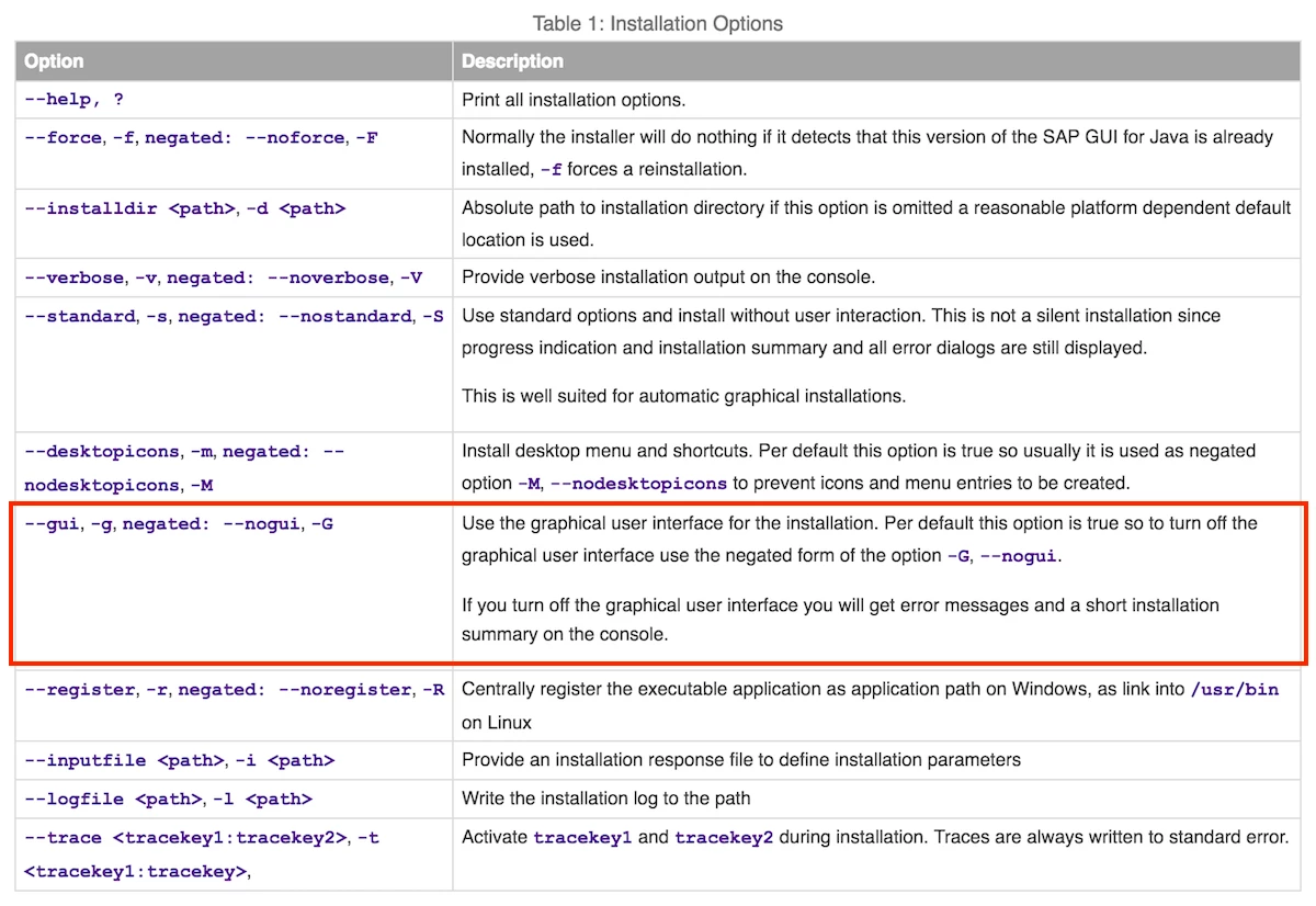

$ java -jar /path/to/PlatinGUI740_1-20012037.JAR uninstall -?
-?  --help           Display this help text
-f  --force          Force installation and reinstall if already installed
-F  --noforce        Don't force installation and reinstall if already installed
-v  --verbose        Provide verbose output on stderr
-V  --noverbose      Don't provide verbose output on stderr
-s  --standard       Use standard options without user interaction
-S  --nostandard     Don't use standard options without user interaction
-m  --desktopicons   Install desktop menu and shortcuts
-M  --nodesktopicons Don't install desktop menu and shortcuts
-g  --gui            Use graphical installation gui
-G  --nogui          Don't use graphical installation gui
-r  --register       Register executable with system
-R  --noregister     Don't register executable with system
-e  --elevated       Run installation with escalated privileges
-E  --noelevated     Don't run installation with escalated privileges
-z  --slaveprocess   Run installation as inferior slave process
-Z  --noslaveprocess Don't run installation as inferior slave process
-d  --installdir     Specify Installation directory
-i  --inputfile      Specify installation response file
-p  --prefix         Specify installation prefix directory
-l  --logfile        Specify file name for installation log
-j  --jnlpfile       Specify file name for JNLP file
-c  --codebase       Specify URL for installation code base
-t  --trace          Specify trace keys separated with ":"

Interesting, their source includes PlatinManual_10-XXXXXXXX.zip which unzips into ~/docs/. Searched through ~/docs/manual.html and found more info in section "5.1.1 Advanced Installer Options" including more install options:
Tried --nogui but got the same prompt...
Enough fiddling...opening a ticket with SAP...
