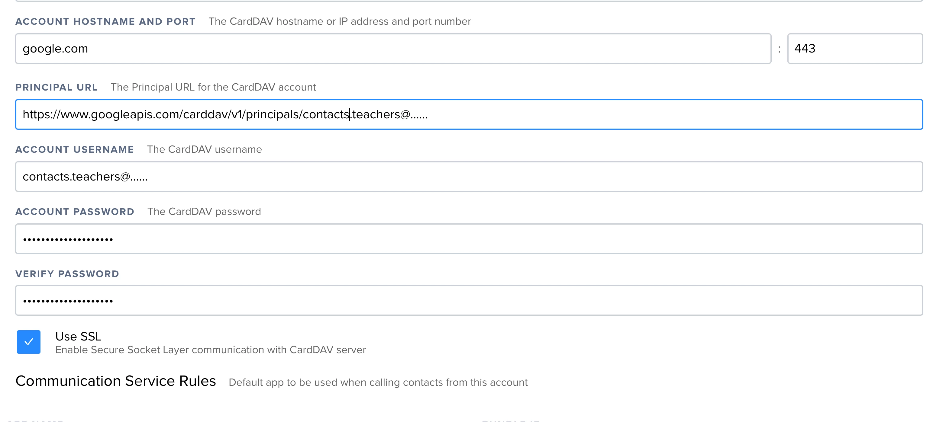

So I was tasked with sending out a managed contacts list to our different dept.s and this was how I did it- created an account for each contact list named by dept like this- contacts.teachers@......... then set up in JAMF. This works fine as we then log into the account and update as needed. The end user can also still add their own contacts to the phone without messing up our managed list. NOTE: when applied the first time works like a charm, however, if you edit the profile and resend, it asks for a PW. Also, the config profile on the device needs permissions to change settings- this is a problem if you are using JAMF reset/setup as these profiles have this option turned off. HINT: move the device out of scope and back in to get past the password issue. Also, I scoped the contacts app bundle to be used with this account.
