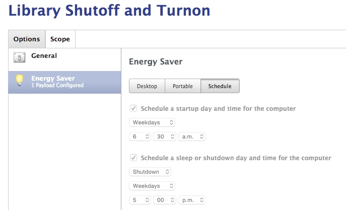

You can also use a configuration profile to turn devices off & on.
  • Mar 9, 2016 4:07 PM UTC
I also use a configuration profile to turn my machines on in a lab, then shut them down in the evening.

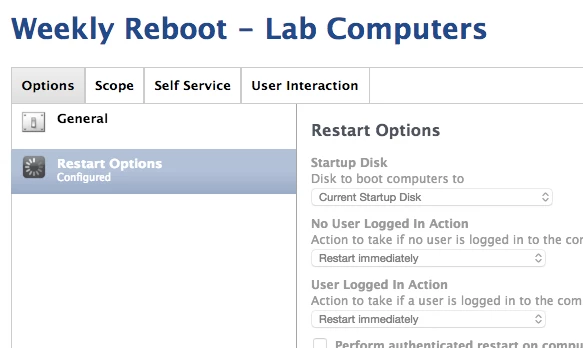

I would personally steer away from the shutdown -r/h options. You don't get reporting that it completed or failed, that is unless you have an extension attribute that checks the last restart date & time and a policy set to run at startup which updates inventory.
If you're running 9.82 (and I think 9.81 too?) just create a policy with only the Restart payload enabled. Set your timeframe which to run on your clients and the frequency you want it to run.
This way it's reported and you can choose a timeframe when the computers are available to restart.

@jduvalmtb 's method will forcibly shutdown if a user is logged in and using the computer. The method above allows you to set options for if someone is logged in or not.

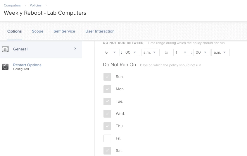

@aporlebeke What I don't understand is how to use the policy method to reboot the machines nightly. If I create a policy with only the restart payload configured, as pictured above, how do I configure the Trigger and the Frequency to have a nightly reboot as say, 2:00 AM?
apizz
Forum|alt.badge.img+15
  • Jan 30, 2019 8:34 PM UTC

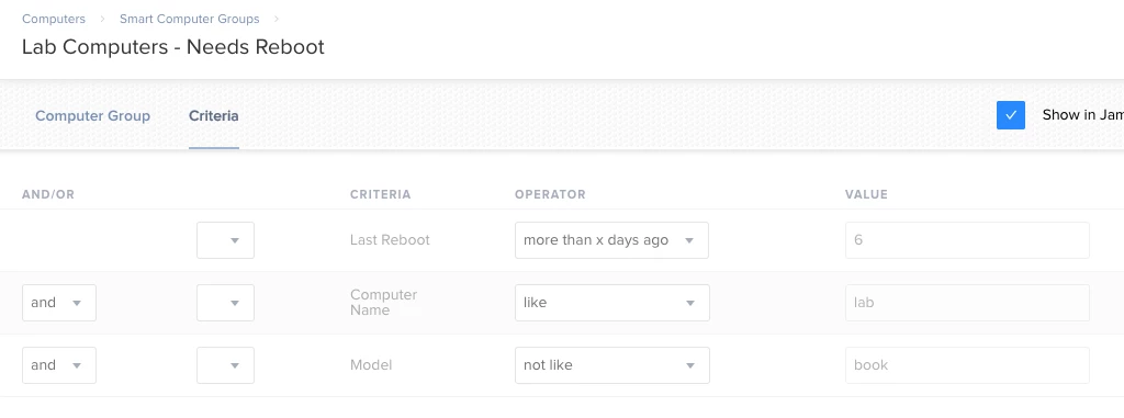

@Morningside So the smart group I have configured is what pops the lab machines into the policy scope based on an extension attribute which reads the date & time of the last reboot. I have this set to more than 6 days ago to achieve the desired weekly result.
The policy itself, which is set to trigger once a week, I have client-side limitations setup such that it only runs on the day I want and between the hours I want, in this case Friday mornings between 1 & 5:59 am (this after our Jamf Pro server completes its daily database backup). So even if lab machines are in the group, the policy doesn't run until the desired day & timeframe.
With the once a week trigger, this avoids the policy from running again, as we don't have the machines update inventory on startup in order to collect the new last reboot date.
Hope that makes sense.
  • Jan 31, 2019 5:36 PM UTC
@aporlebeke Thanks for that! I have set mine up for my lab iMacs as shown above and could not be happier. I appreciate the help!

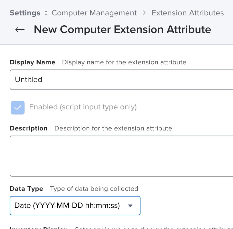

  • Jan 14, 2021 8:55 PM UTC
@apizz
I've dug around and can't figure out how you got that custom operator, "more than x days ago". Got any tips?
Were on Jamf v.10.25.
TIA!!!
apizz
  • Jan 14, 2021 8:58 PM UTC
@geebee your EA has to be configured as a 'Date'

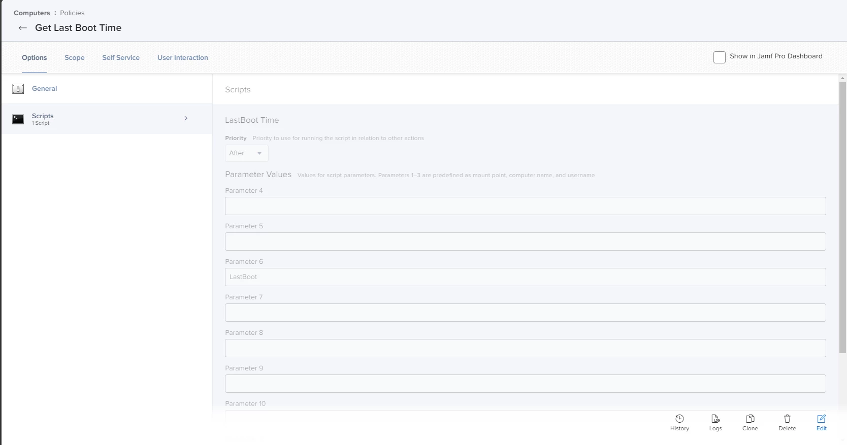

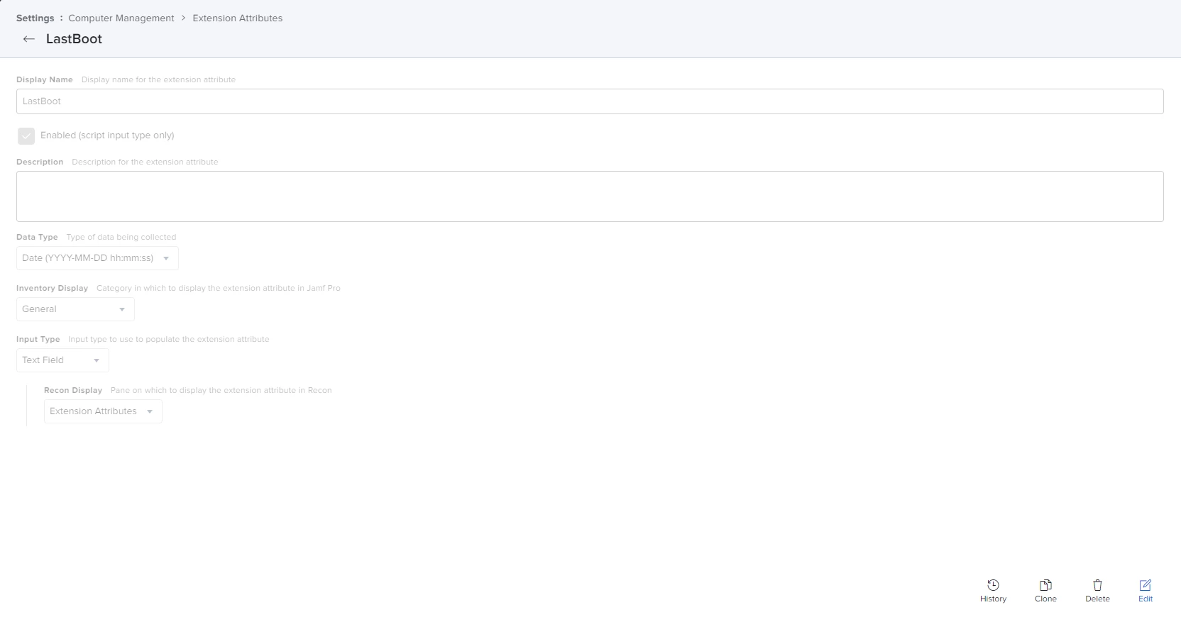

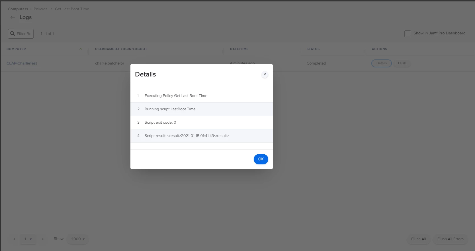

Hello,
Trying to use the script referenced here have created a Extension Attribute as shown in the image below, and have the policy setup as shown in the second image the policy runs successfully but never puts the key into the computer extension attribute record
Thanks for your help in advance

  • Jan 15, 2021 6:29 PM UTC
@JAMFInfra You have a policy running a script, which isn't correct. You need to put the script for returning last boot time in the EA itself by changing the input type from "Text Field" to "Script".
apizz
  • Jan 15, 2021 6:31 PM UTC
There's nothing inherent about running a script as part of policy that will return data to an extension attribute
  • Jan 19, 2021 9:24 AM UTC
Thanks so much the EA is working now!
  • Aug 24, 2023 5:43 PM UTC
there is no "Energy Saver" payload for config profiles in Jamf Pro. Nor do I see any other payload that could facilitate a reboot
