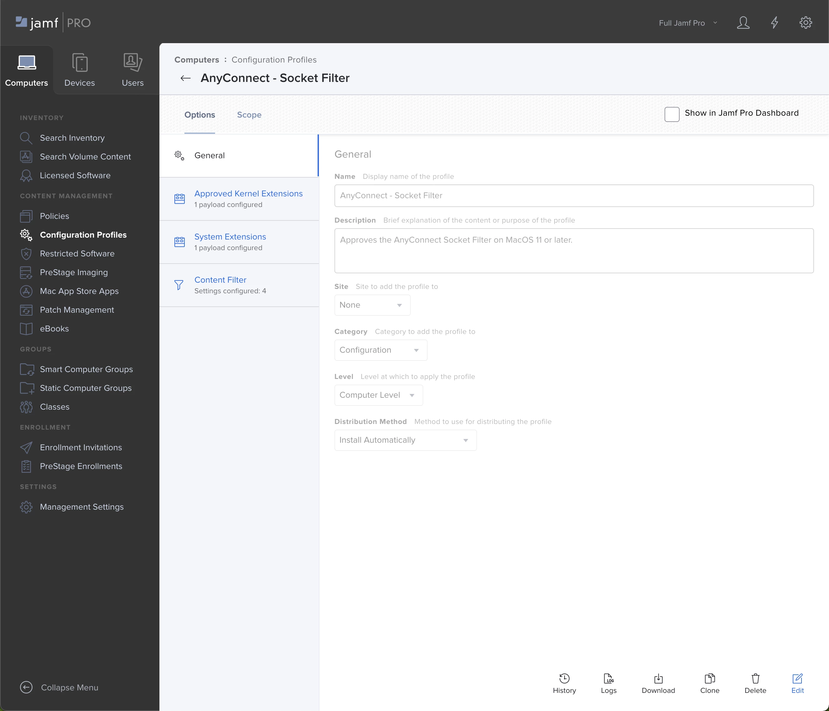

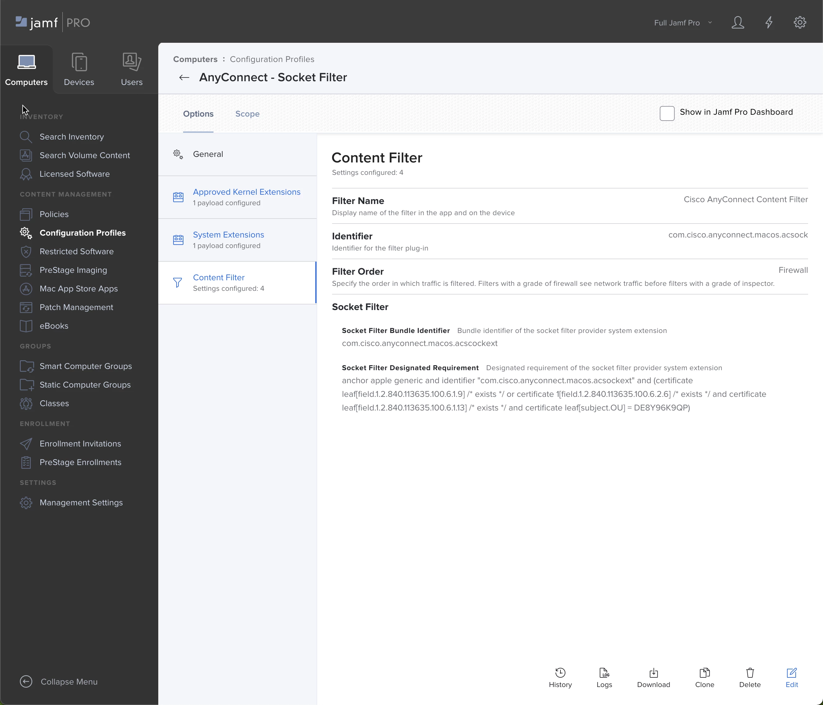

@jon.verret We have it configured this way. One thing I learned is the Configuration Profile has to be installed on the Mac BEFORE AnyConnect drops the system extension. If the system extension is on their first the user must approve. Its just how system extensions work and is kinda dumb, its not a JAMF thing. It is possible to remove a System Extension but you have to disable SIP first, at least for now according to the binaries notification. The screenshot below is the configuration profile that resulted from a JAMF ticket on this matter.

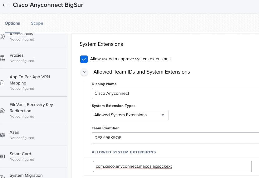

In addition to this , we are deploying a configuration profile with settings for system extensions ans content filtering as seen below. This works for us. The installation is running silent.

The Socket Filter is causing the DNS issues.. after removing the Socket Filter payload, the DNS issues stopped for me. And we're able to still manage as we did with Kernel Extensions and macOS 10.x

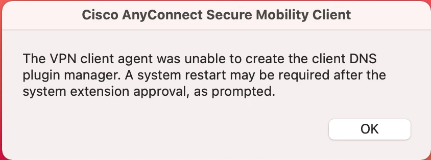

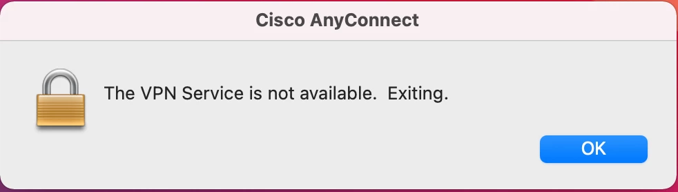

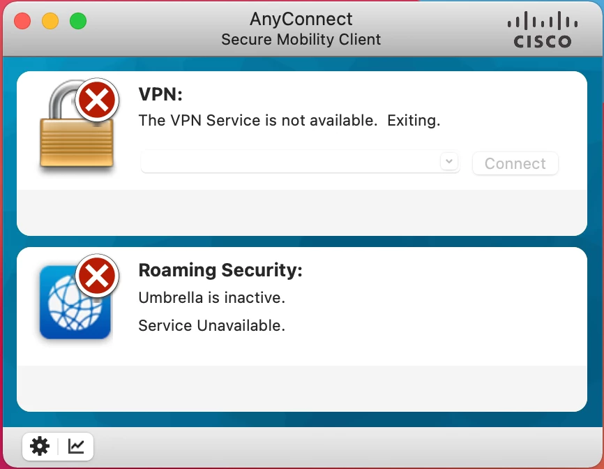

I've got AnyConnect running on Big Sur thanks to the tips here, but am having issues reinstalling the app if it's been removed. Has anyone had success reinstalling?
In testing I had a user uninstall AnyConnect and DART using the uninstallers in the Applications folder. We performed the testing needed and then pushed the app back out. Now we are getting the errors in the attached screenshots. There are no system extensions to install, and we did not remove the config profile during the uninstall process, it's all still in place from the initial install. The system extension warning pops-up every 10 seconds or so making the Mac unusable. I can repeat this on other Macs as well.
