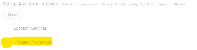

Hi,
we solved this issue by disabling the "Transfer Information" setup assistant option in our prestage enrollment.
So now our user see the setting during enrollment, but at least it works.
I can't say if the issue persists with Monterey, but at least with Big Sur we got rid of it.

Hi,
Hi Thomas
Thanks for this tip. I can confirm that this works for macOS Monterey (12.01)
It's still a bit of an annoying "hack" to have to do as the user may be confused what to do there until they see the skip button. But better than not having their account created.
