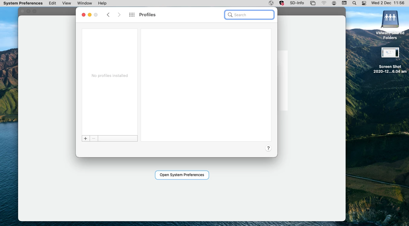

Got a machine here to enroll, download the QuickAdd.pkg, everything appears to work as expected. Starting up Self Service the first time gives the popup about approving the MDM profile in System Preferences, but when I click the button to go over into Sys Pref, there's no profile there to approve. Totally blank. Is there an extra step or a different method now?

Also on opening Self-Service.app there is a request to Approve the MDM Profile, this happens on each launch of the app. If the request box is clicked, opens System Preferences/Profiles which is showing no profiles.

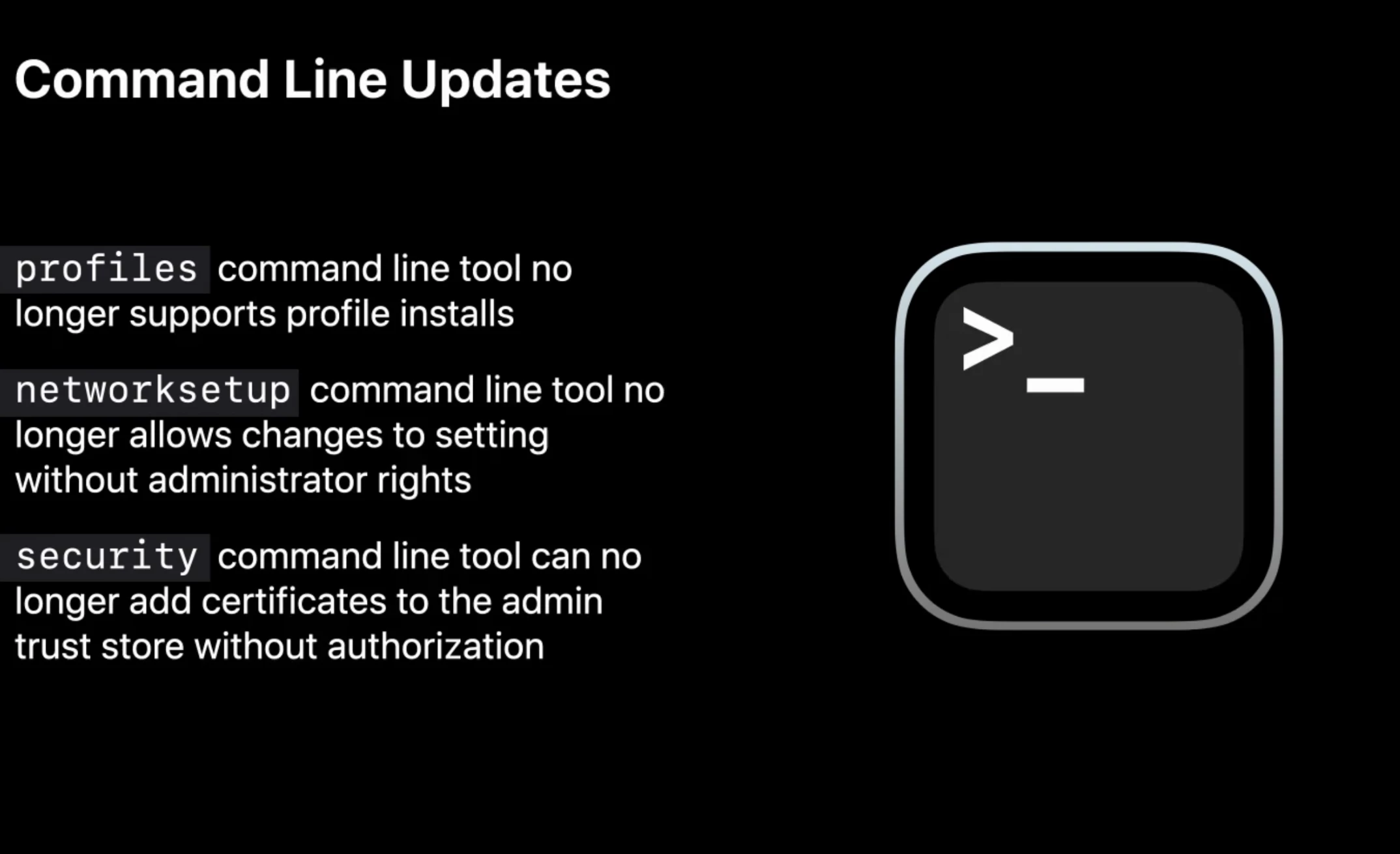

Here is a slide from a Apple Big Sur deep drive presentation - the first point is the killer for older methods of enrolment into MDM for Big Sur
If you still wish to use the old methods then they must be enrolled when still running macOS Catalina (or earlier) and then upgraded to macOS Big Sur post enrolment
I'm sure some clever developer may possibly find a way around this, but also I'm sure Apple will shut that door soon after like they have done with Imagining and you will end up swimming against the tide of change.

@garybidwell We think our main issue is that we do not see the MDM Profile to to Approve it. Just comes back with a blank Profile Preference dialog box. See screenshot.
  • December 8, 2020
