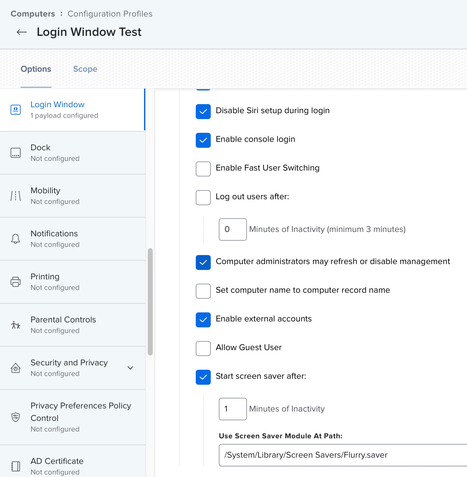

Hello Howard_Trevor,
I just did a test configuration profile and enabled the "Start screen saver after:" for 1 min and it worked on my test iMac.
This setting is in Configuration Profiles>>Login Window>>Options.
I'm using a Big Sur 11.4 iMac.
  • July 14, 2021
From my testing, I have found that the profile only applies to the currently logged in user. The Mac will ignore the profile when sitting at the login window.
  • July 14, 2021
No luck on my end. Ive already got that set at 10 minutes, made a change for 1 minute to speed up my testing and still no luck. Tested on machines on 11.2 and 11.4

  • July 14, 2021
@nelsoni You sir seem to be correct. Its now recognizing the 1 minute change I made when a user is logged in but no change at the login screen. That is interesting. Is there any way around that? What in Big Sur changed that wasn't in Catalina because those machines run screen savers from the login screen. Im a little worried about burn in on these new machines. It doesnt take long for these screens to start burning in the login boxes, seen it on a few machines with the connect keyboard and mouse message at the login screen being burnt into the background when a user logs in.

  • October 26, 2021
Unfortunately, from my initial tests with macOS 12.0.1 (Monterey), the same holds true... No screensaver, via config profile, over login window.
