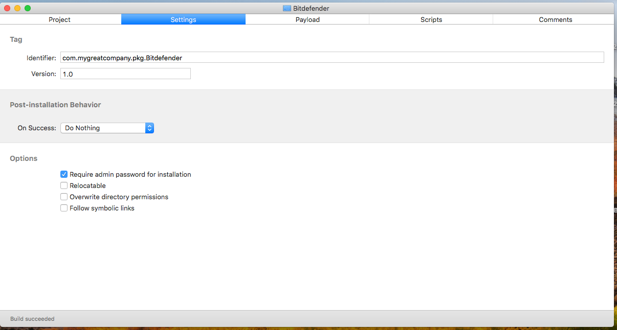

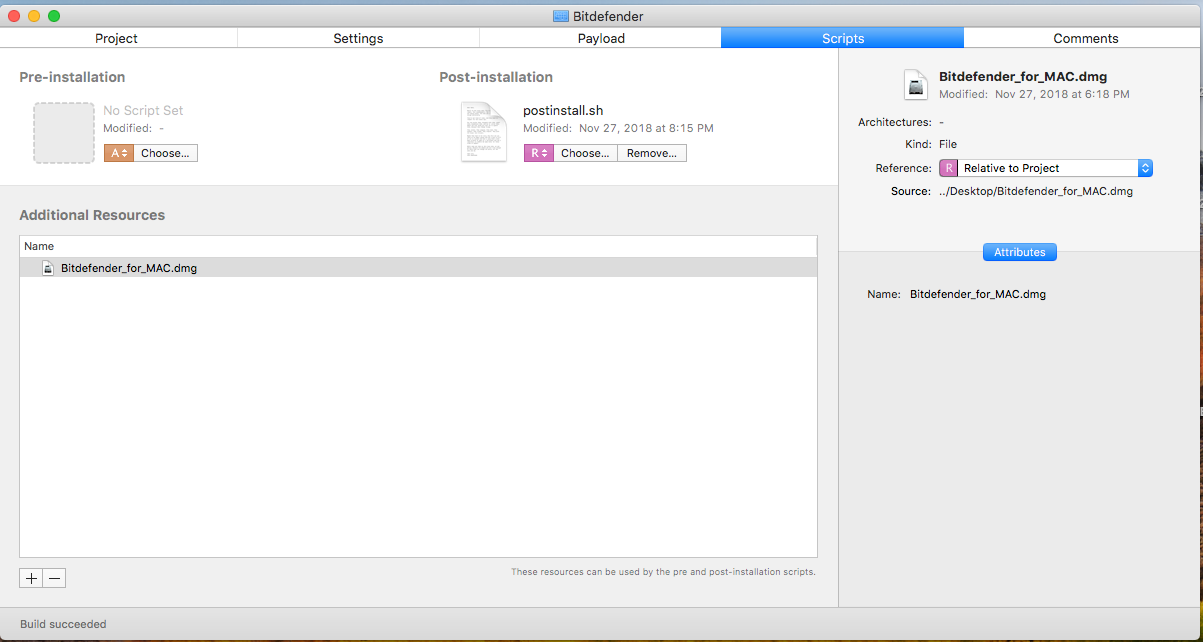

Anyone have any advice on which Composer method should be used to create this package.
  • April 18, 2018
You don't use Composer. I use Packages, put the entire dmg into a project with a postinstall script that I reworked from @rtrouton .
# Determine working directory
install_dir=`dirname $0`
# Specify location of the Junos Pulse disk image
diskimage=$install_dir/"Bitdefender_for_MAC.dmg"
# Specify a /tmp/junospulse.XXXX mountpoint for the disk image
tmpmount=`/usr/bin/mktemp -d /private/tmp/bitdefender.XXXX`
# Mount the disk image to the /tmp mountpoint
hdiutil attach "$diskimage" -mountpoint "$tmpmount" -nobrowse -noverify -noautoopen
# Install Bitdefender
/usr/sbin/installer -dumplog -verbose -pkg "$(/usr/bin/find $tmpmount -maxdepth 1 ( -iname *.pkg -o -iname *.mpkg ))" -target "$3"
# Unmount the disk image
/usr/bin/hdiutil detach "$tmpmount"
# Remove the /tmp mountpoint
/bin/rm -rf "$tmpmount"
exit~[upload](d89cb861151043599020941bd13b060a)

@ProFX So the directions seem a little sketchy.
  • "Click Scripts and configure the Files and Processes payload. Enter the following Execute Command: installer –pkg /Users/Shared/antivirus_for_mac.pkg –target /" * This part doesn't make any sense and the screenshot doesn't match. Is this a script or is this an execute command?
KyleEricson
  • November 28, 2018
@franton Can you share more details with your project in packages. I was able to create a package, but the GUI said there was a error and I'm afraid that JAMF will not like that. The software seems to have installed find though.
  • November 28, 2018
@kericson Yeah, that part of the instructions were a bit wonky. I used the "Execute Command" field under "Files and Processes". Also, the command I used was this:
/usr/sbin/installer -pkg "/Library/Application Support/Bitdefender/antivirus_for_mac.pkg" -target /
I was having issues with the original command shown in the instructions on the Bitdefender site and JAMF support had me modify it to the above. Note that I changed the location of the installer file as well.

  • November 29, 2018
@kerickson Yeah I put the installer command in the "Execute Command" section. It needs that to actually install the package as root once it downloads the bitdefender package from Jamf. I also noticed that you can't copy and paste it because of something with the text encoding used on their website; the dashes aren't actual dashes and the command will fail. So just type the command yourself in the necessary field and it should work. It's been working like a charm for me in High Sierra. Now Mojave security just messed up everything again smh. For my computers on Mojave I have to go to each machine and enable Full Disk control manually for my modules to work. Hope this helps!
