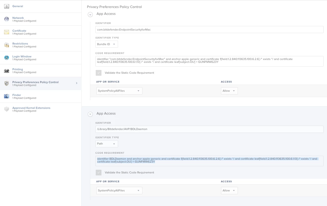

I just got this working fairly easily following these instructions: https://www.jamf.com/jamf-nation/articles/553/preparing-your-organization-for-user-data-protections-on-macos-10-14
I used the Privacy Preferences Policy Control settings and have two App Access settings:
Identifier: com.bitdefender.EndpointSecurityforMac
Identifier type: Bundle ID
Code Requirement: identifier "com.bitdefender.EndpointSecurityforMac" and anchor apple generic and certificate 1[field.1.2.840.113635.100.6.2.6] / exists / and certificate leaf[field.1.2.840.113635.100.6.1.13] / exists / and certificate leaf[subject.OU] = GUNFMW623Y
Validate the Statis Code Requirement: checked
App or Service: SystemPolicyAllFiles Allow
Identifier: /Library/Bitdefender/AVP/BDLDaemon
Identifier Type: Path
Code Requirement: identifier BDLDaemon and anchor apple generic and certificate 1[field.1.2.840.113635.100.6.2.6] / exists / and certificate leaf[field.1.2.840.113635.100.6.1.13] / exists / and certificate leaf[subject.OU] = GUNFMW623Y
Validate the Static Code Requirement: checked

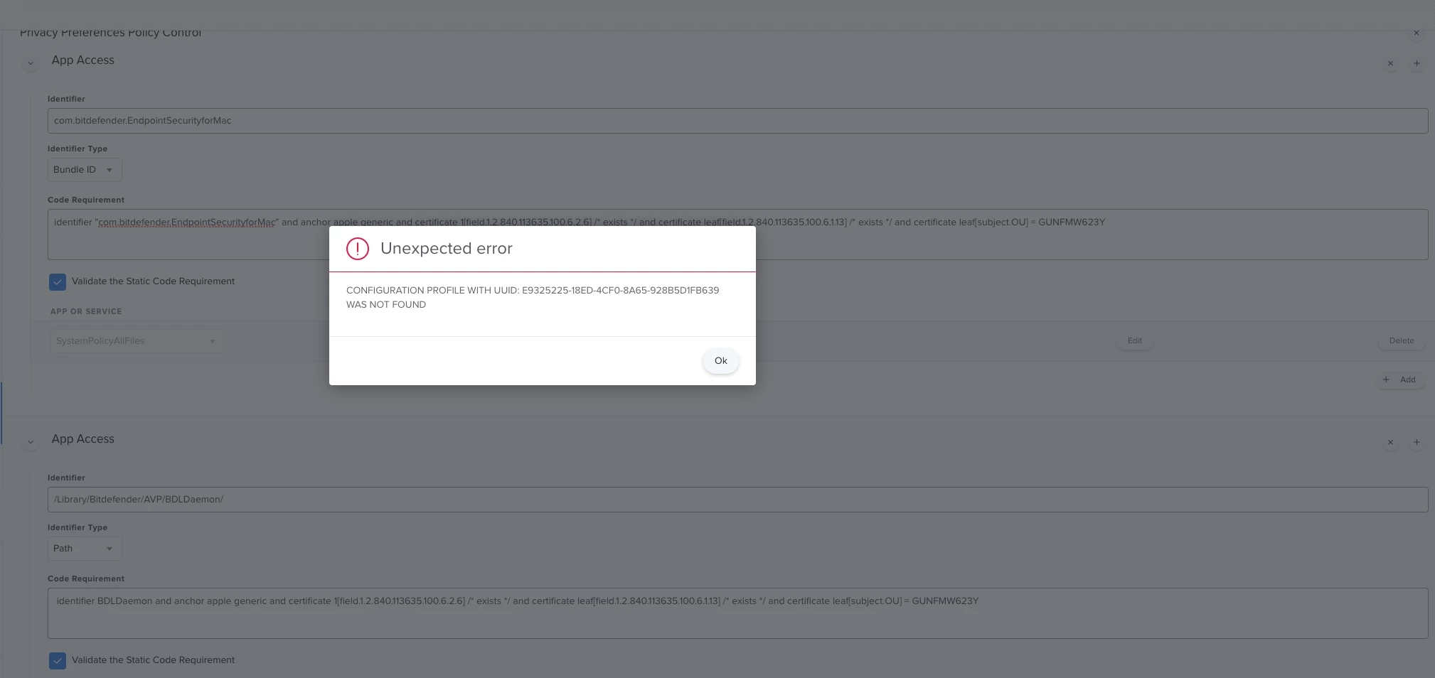

I used the settings you outlined, copied and pasted. But, I get an error when deploying the config through JSS (10.15.1) "In the payload (UUID: CA355A38-F029-4914-A398-00CE78B2D6D1), the key 'Code Requirement' has an invalid value."
Having the same exact issue.
Figured it out, if you copied and pasted, check for a trailing enter and delete it. the cursor should be at the end of the team identity code.
scarmichael68's post is correct, but pay close attention because the post's markdown interpreter screwed up the contents: / exists / should be /* exists */. Compare the texts and the screenshots of the original post and you'll spot the differences.
For easy copy/pasting, here is the same content again, but now formatted properly:
Code Requirement: identifier "com.bitdefender.EndpointSecurityforMac" and anchor apple generic and certificate 1[field.1.2.840.113635.100.6.2.6] /* exists */ and certificate leaf[field.1.2.840.113635.100.6.1.13] /* exists */ and certificate leaf[subject.OU] = GUNFMW623Y
Code Requirement: identifier BDLDaemon and anchor apple generic and certificate 1[field.1.2.840.113635.100.6.2.6] /* exists */ and certificate leaf[field.1.2.840.113635.100.6.1.13] /* exists */ and certificate leaf[subject.OU] = GUNFMW623Y

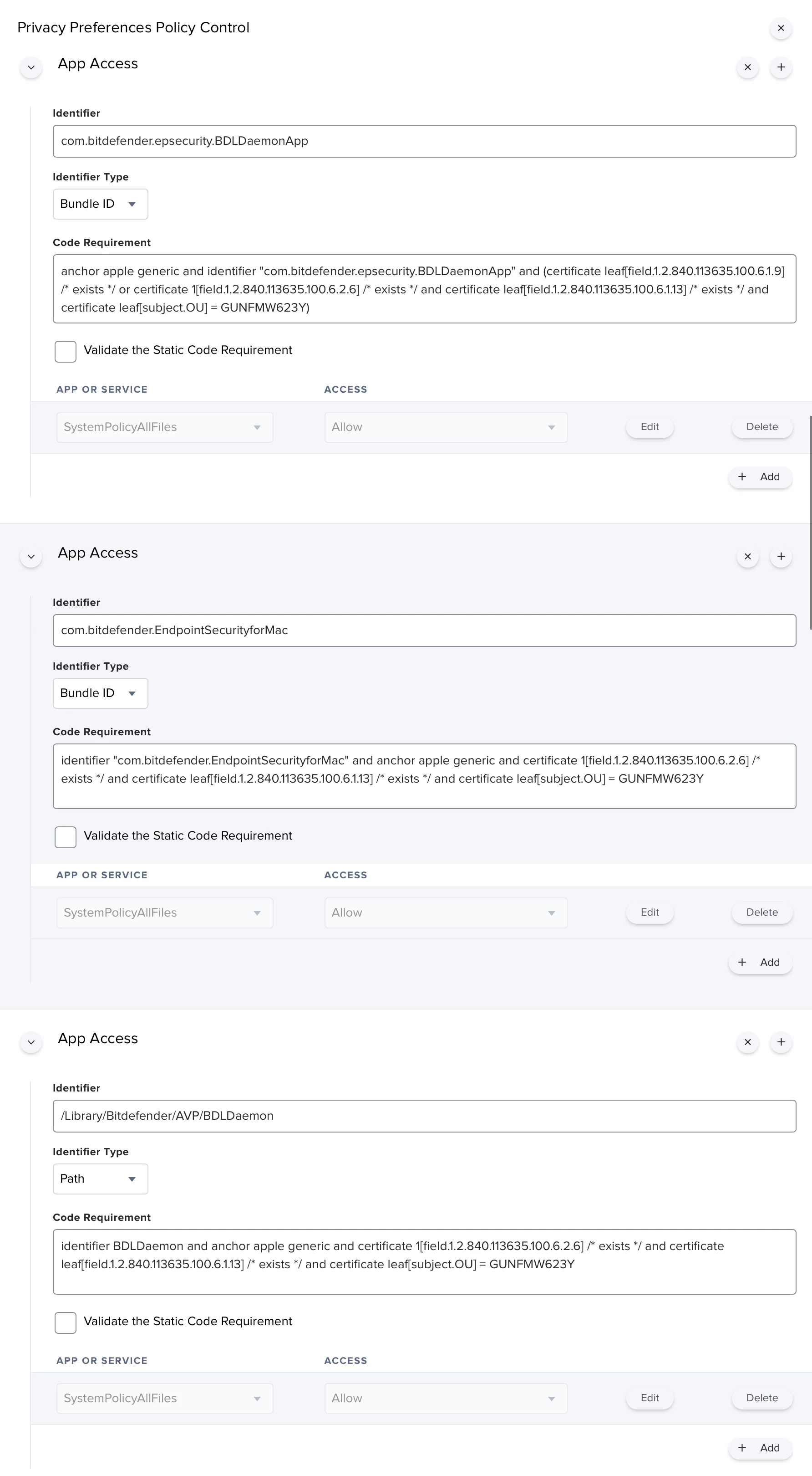

This solution (esp the version correcting for encoding) worked great for me. However for test purposes, I've upgraded a machine to Big Sur, and now Bitdefender wants one more full disk access permission for BDLDaemon.app. I've tried creating a permission that looks like the BDLDaemon one but with ".app", however it doesn't seem to work. Has anyone else updated this solution for Big Sur?
@whabib This what I'm using. It seems to be doing the job in Catalina and Big Sur.

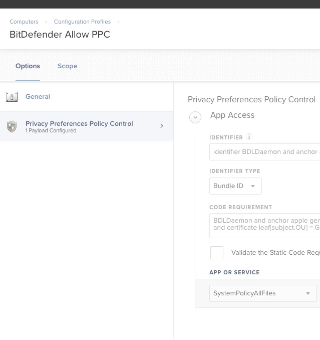

Not sure what I'm doing wrong here. Using @remus payloads, I am at least able to get the BitDefender stuff to show in the Full Disk Access list, however, it isn't checked.
