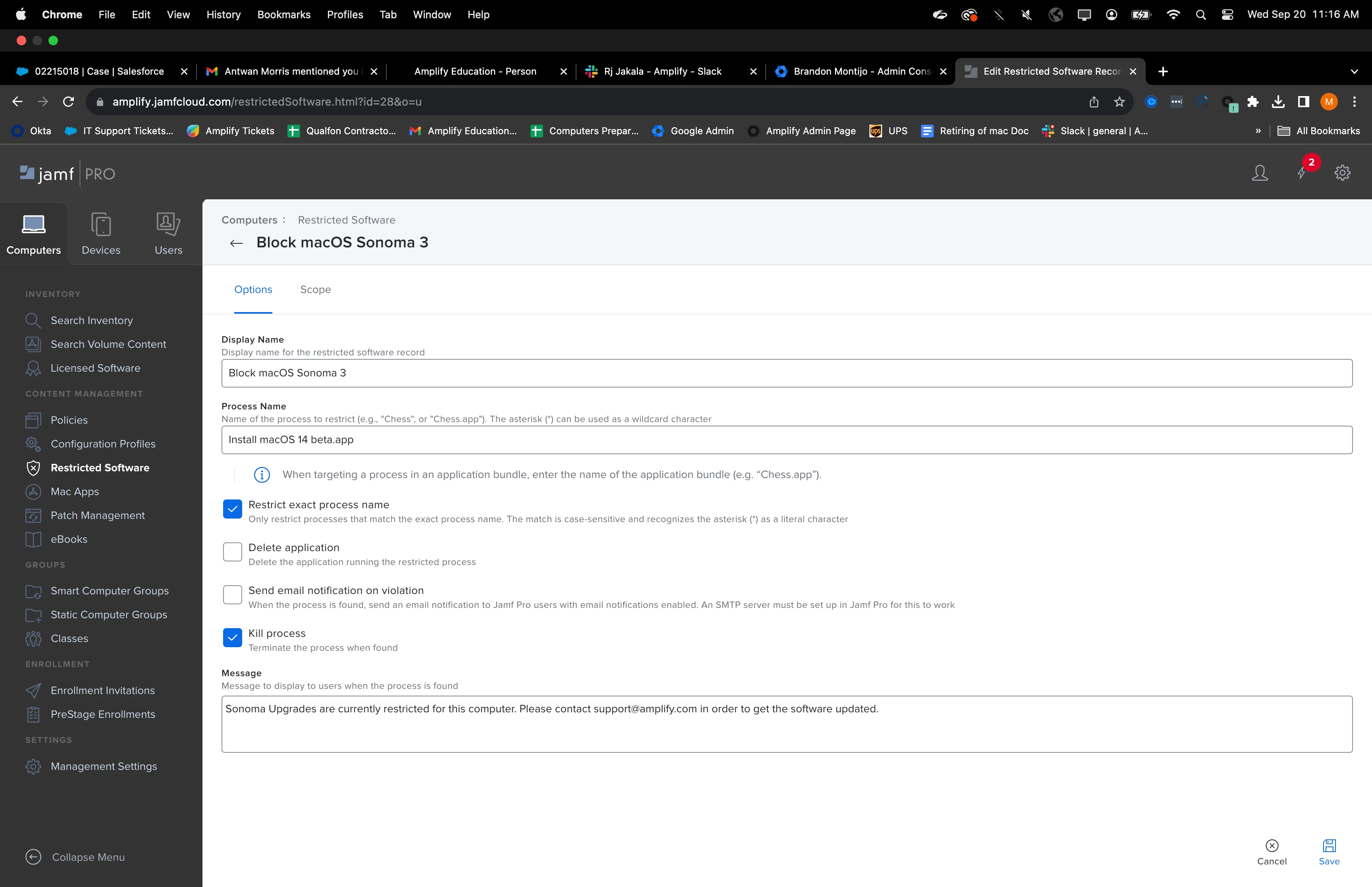

Hello I am attempting to block the Mac OS Sonoma BETA my boss advised me that my restricted profiles i created are wrong i will post a picture of what i have done so far when i scope the restricted software to my test mac machine it always installs and downloads the sonoma beta not sure what i am doing wrong

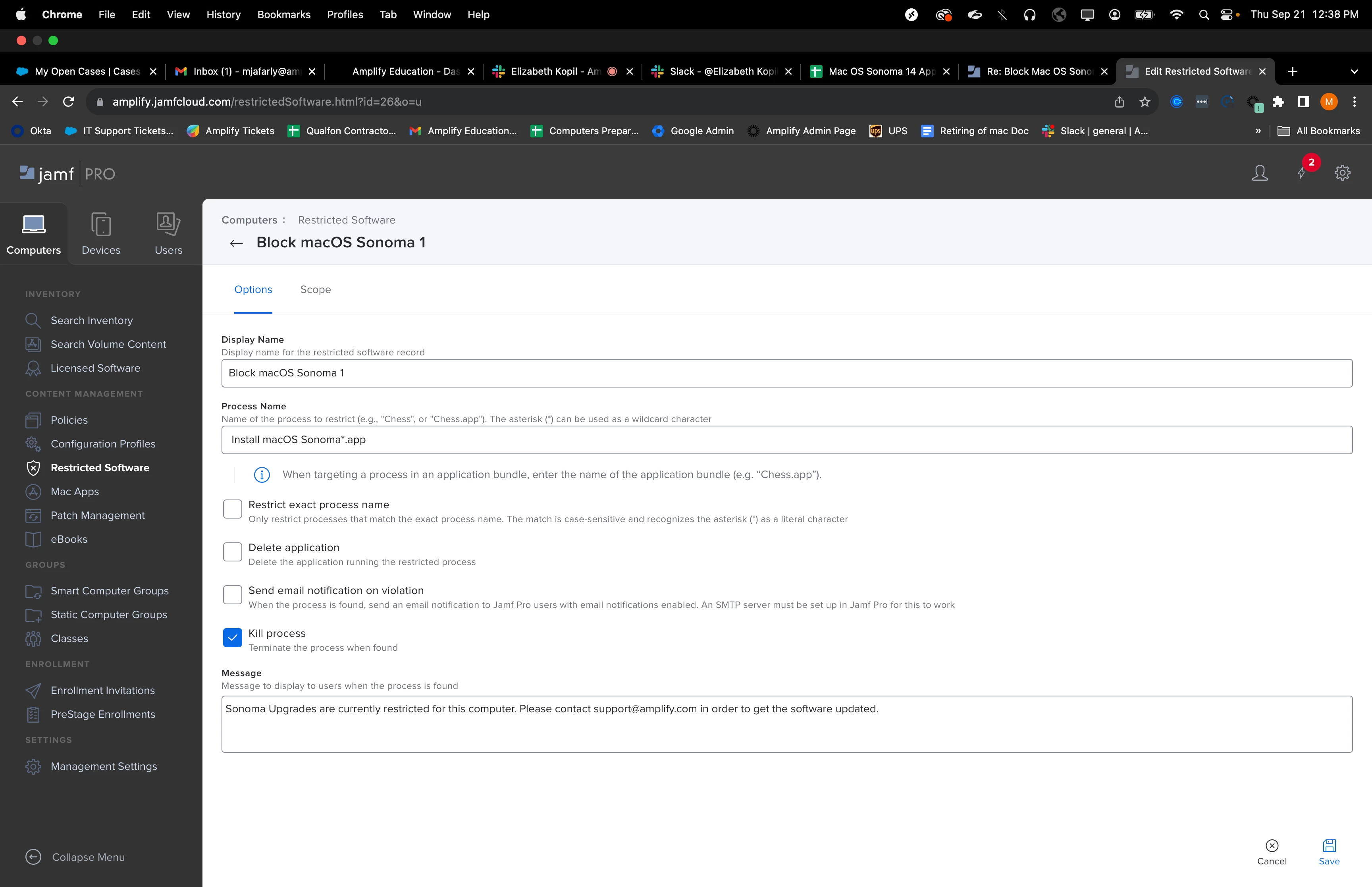

Use a wild card gor the process name: Install macOS Sonoma*.app
Untick restrict exact process.

ok thank you for this and once i put in Install macOS Sonoma*.app and try to download the sonoma beta it will kill the process correct?
