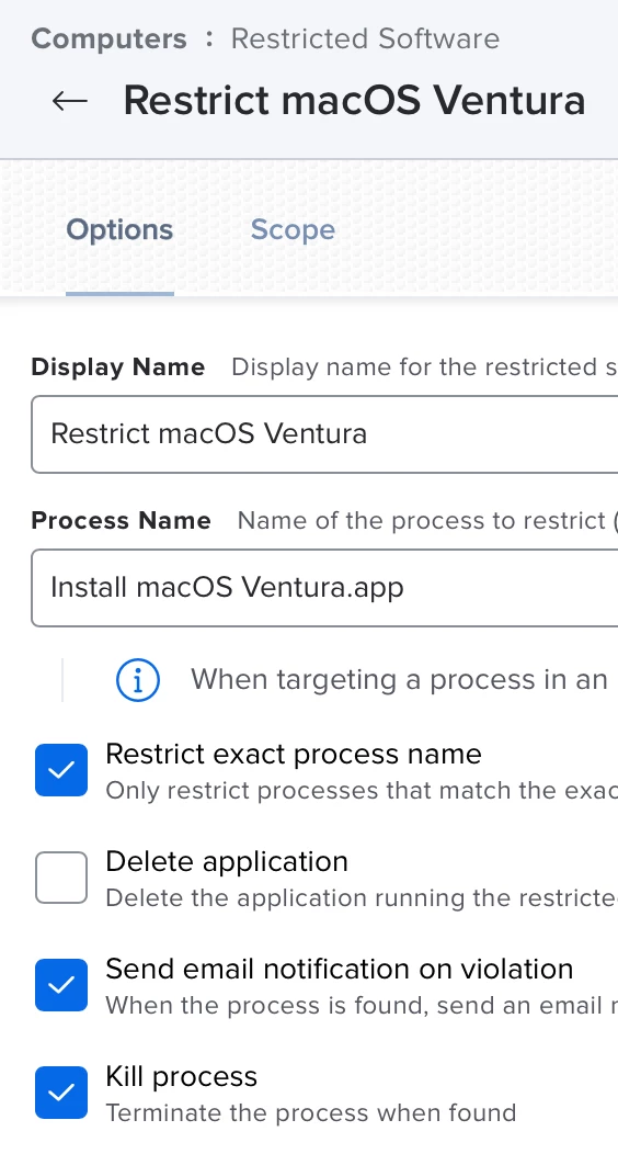

Hi there - we use the Restricted software feature.  We then have a static group where we will allow users to be added for UAT / Pilot until we allow all others to upgrade.
  • September 28, 2022
Thanks @duff2481-1  I read that for certain versions that of Monterey the .app block won't be enough. Do you have something there to account for that? Also, can you elaborate on how the static group is set up? I assume you could add an exclusion to the configuration profile?

@auser For any Mac running macOS Monterey 12.3 or higher the macOS Ventura upgrade won't require downloading a full installer, and instead will use a much smaller "delta" updater similar to how the "minor" .1 -> .2 updates are installed. Currently the only way to block the "delta" update mechanism is to deploy a Configuration Profile to defer Minor OS updates (Apple has acknowledged this should be a deferral for a Major OS update but as of macOS 12.6 the logic in softwreupdate treats it as a Minor update)

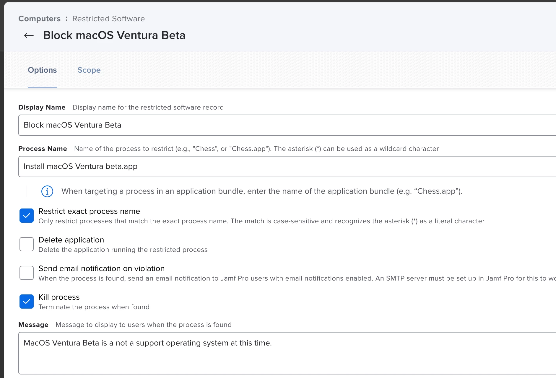

Always defer, especially if you do not actively test the beta seed. Even if your device management is ready for Ventura day 1, odds are your security tools wont be. In my experience it usually takes about 3 months for most vendors to be ready for the new OS, and another 3-6 months for your internal application owners to be ready.  I cut the new OS lose after 90 days and don't play the horse and pony show of internal departments prioritize down supporting the new OS.
In years past you can use a software restriction targeting the installer (install macOS Ventura.app) and kill it whenever it is run. Rumor mill is this wont work for Ventura, but I have not found proof of that yet. In the very least I recommend setting up OS update Deferrals in the restrictions payload of a configuration profile.
  • October 24, 2022

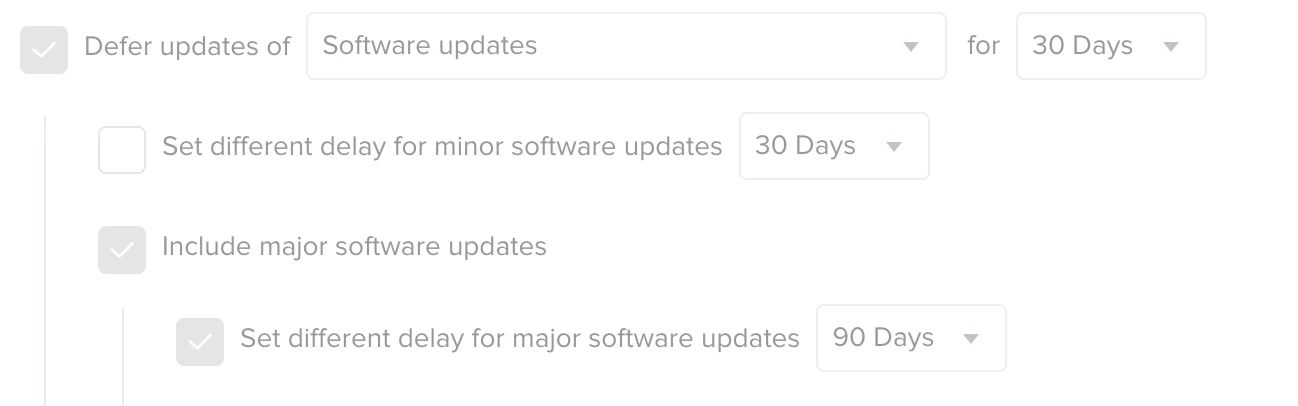

Confirmed Restricted Software still works to block Ventura. I did a software update from a Monterey tester. We have both Restricted Software and Configuration Profile Deferrals setup, for 90 days.

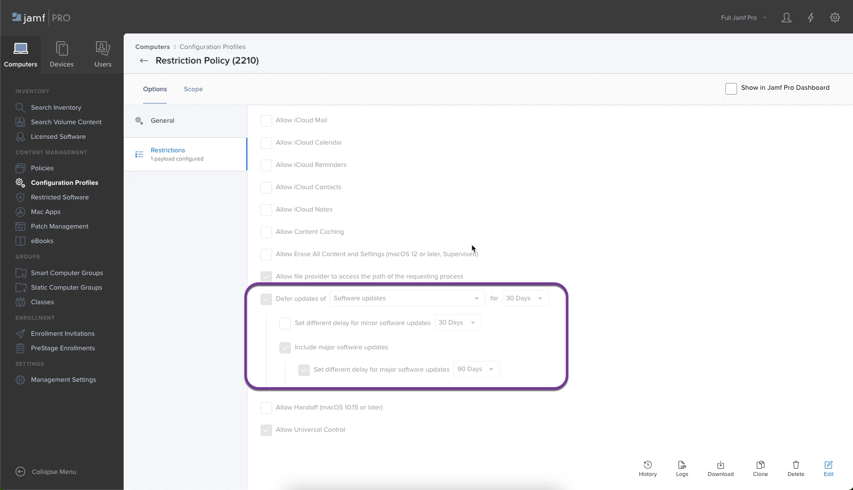

@AJPinto I thought I have the right deferrals in place, but so far it's letting me see and download the full installer (12.15 GB) on an MDM Mac. Seems like I'm copying you correctly?
Trying to block Ventura, but allow 12.6.1 (minor update?).

You are not doing the wrong thing. Apple screwed up, and did not tell anyone. Once you get up to 12.6.1 things will work as you expect. However you must do it by Thanksgiving or users can upgrade to Ventura on their own.

In typical fashion, documentation from Apple came a day late and a dollar short. I suggest emailing your Apple rep and complaining and submitting feedback.
https://support.apple.com/en-us/HT213471

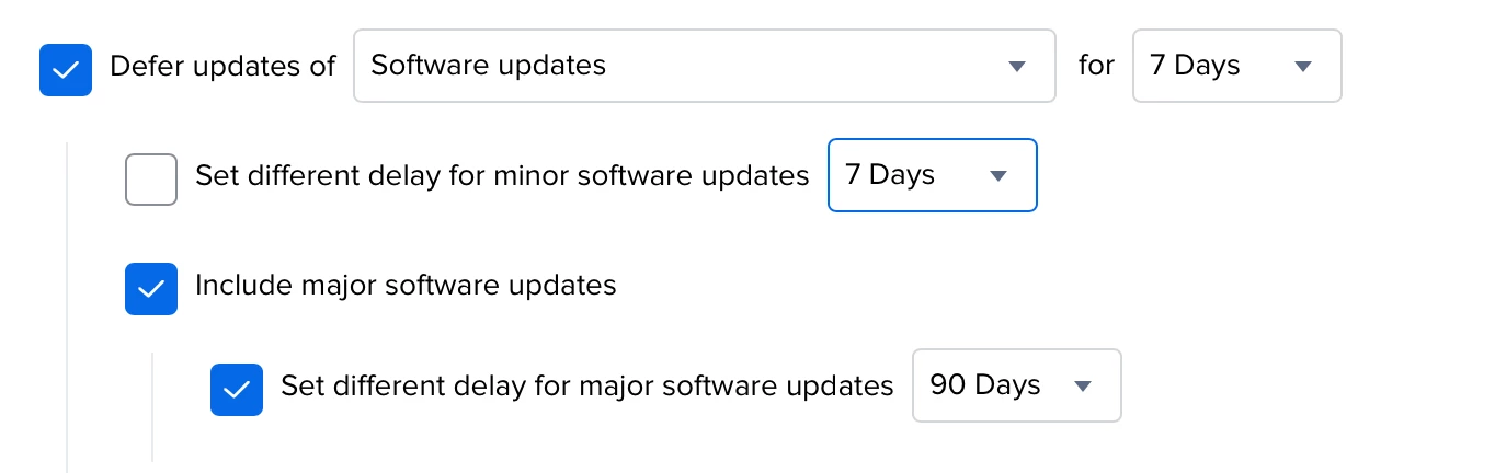

Hi, struggling here as well with this.
Anyway, the info published by Apple here is not precise in the least: https://support.apple.com/en-lamr/HT213471
  • "macOS Monterey 12.6.1 and later:
Continue to use the major update delay setting to prevent Mac computers in your organization from offering macOS Ventura for up to 90 days." - tested several times and it's not working (edited)
  • "macOS Monterey 12.3 through 12.6:
Use both the major and minor update delay settings to prevent Mac computers in your organization from offering macOS Ventura for up to 90 days. If you currently have a longer delay period for major update than minor updates, increase your minor update delay to match the desired major delay period." - That's the first thing we tried and it's not working
  • Even on macOS Big Sur, Ventura is appearing as available.. (Either delaying major and minor updates)
Additionally, when my profiles actually take effect, they lose it after a restart for example.
Currently they don't seem to take effect not even temporarily....

I think it depends on what macOS version you'r on.  If 12.3 or newer, I don't think so as Ventura shows as minor update from my understanding. 12.0-2, you could allow minor and block major to have those updated to 12.6.1. We have taken the stance of denying minor and major updates for the 90 days out of caution really.

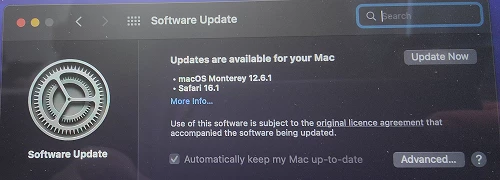

Jay_007
  • October 30, 2022

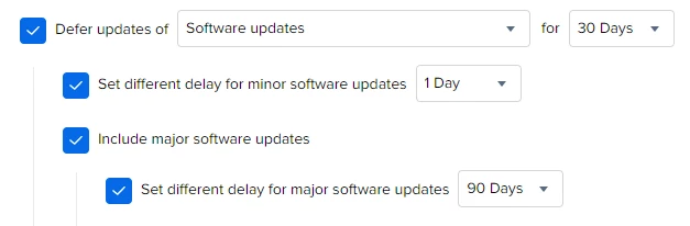

Yeah, it was still offered to our Macs too even though they are supervised. After some trial and error, this is how I managed to hide Ventura and only offer 12.6.1.
MajorProduct: 012-92138>(Title:macOS Ventura Version:13.0, Identifier:com.apple.InstallAssistant.macOSVentura, IconSize:0, Deferred:1, Deferred Until:2023-01-22
  • November 2, 2022
I am following your steps Jay and it is still advertising ventura
Jay_007
  • November 2, 2022
Others are saying the same on another post too. I'm not sure why that seems to work for me and not anyone else. There is definitely some weird behaviour going on with Ventura. It's still being advertised to some that have updated to 12.6.1 and excluded major updates even though Apple have stated that they have automatically deferred it for supervised computers. Sorry that I can't help further.
