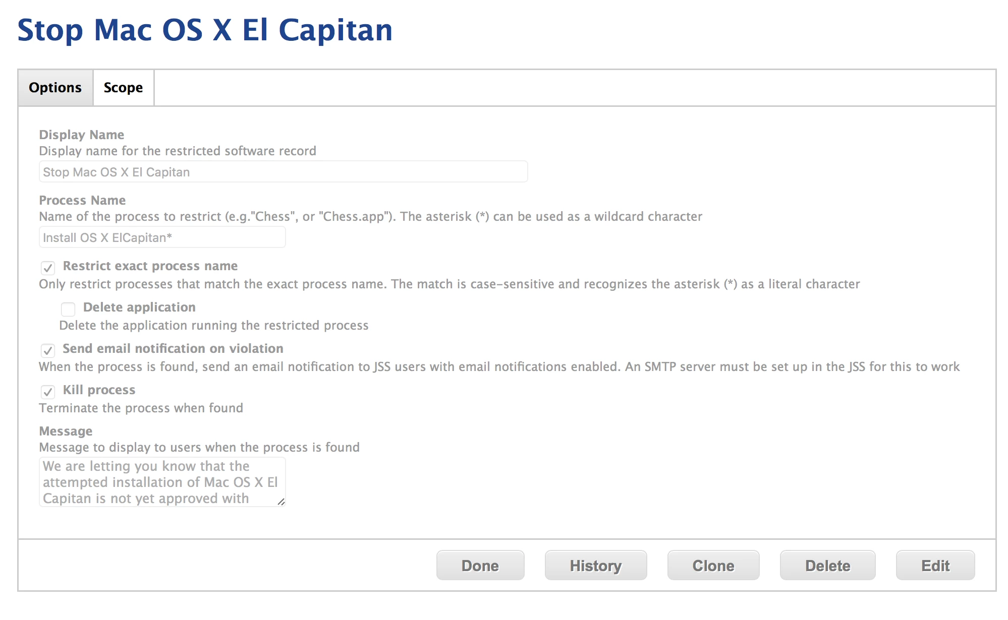

Create a software restriction. We also set it to delete the installer since it's a 5 GB+ file. We did the same for Yosemite this time last year and it worked very well.
Here's our settings (attached):
  • October 1, 2015

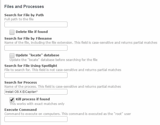

Where do you guys set it within the policy. I don't see 'Process Name' under any category within Policy creation process. Is it under Files and Processes? Maybe mine looks different because we are still on 9.73?
What would be the trigger for something like this?
  • October 5, 2015
@Vitamin-Z It's not by creating a policy, but rather through the "Restricted Software" menu on the Computers sidebar.
  • October 5, 2015
Got it. Appreciate the quick response @btaitt ! Thanks much!

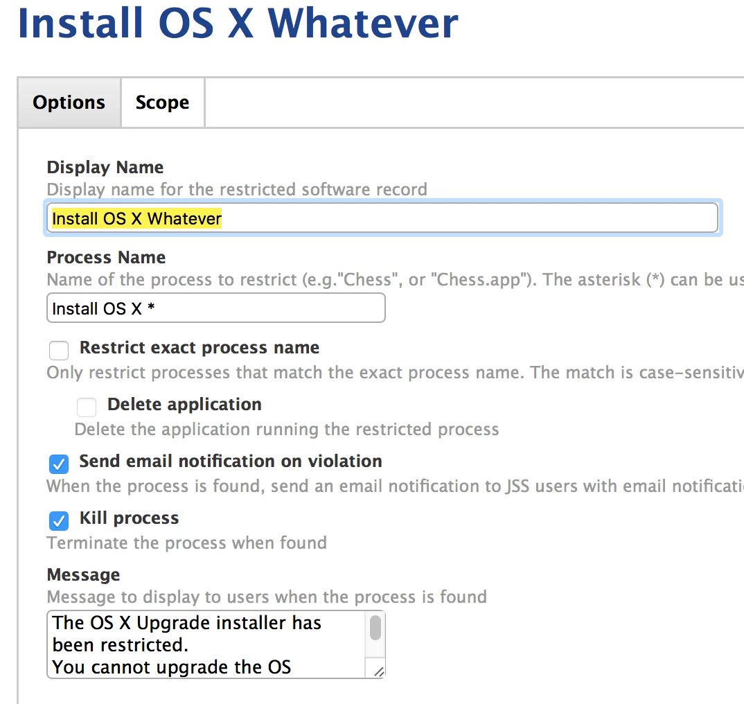

  • October 26, 2015
@GNegron2015
I had individual restrictions for each release of OS X that appeared in the App Store. Since this thread, I changed it to be One Restriction to Rule Them All.
Process Name: Install OS X *
(See attached Image)
What you lose is 'accurate' accounts of which installer they tried to install.. but in my environment, I don't care. I don't want them to try to install any upgrade as that typically leads to more work for the Help Desk and the Field Techs.
Now to answer your questions:
  1. You can, and it won't effect existing El Caps. It only comes into play when people try to run the installer. If you want a user to be able to run it on a device, then either add that device as an exclusion, or create a static group that is part of the exclusion list of the restriction, and then add devices to that.
  2. So, I feel like this used to be different, but I've not used it for so long, I don't know. I thought I used to be able to chose the delete without having to chose the "Exact" box. But that's not the case now. The * doesn't work in this case and I'd have to go back to having 5 different restrictions. So, in order to leave my restriction as is, I wrote a script to check devices to see if they had any of the installers and then remove them.
  3. This (should) block any attempt to run "Install OS X blah", no matter what the source, download, copied from share, USB, whatever. If one were to change the name of the installer, that would be sufficient to circumvent it, so it's not foolproof (and might be where the * is more helpful).
