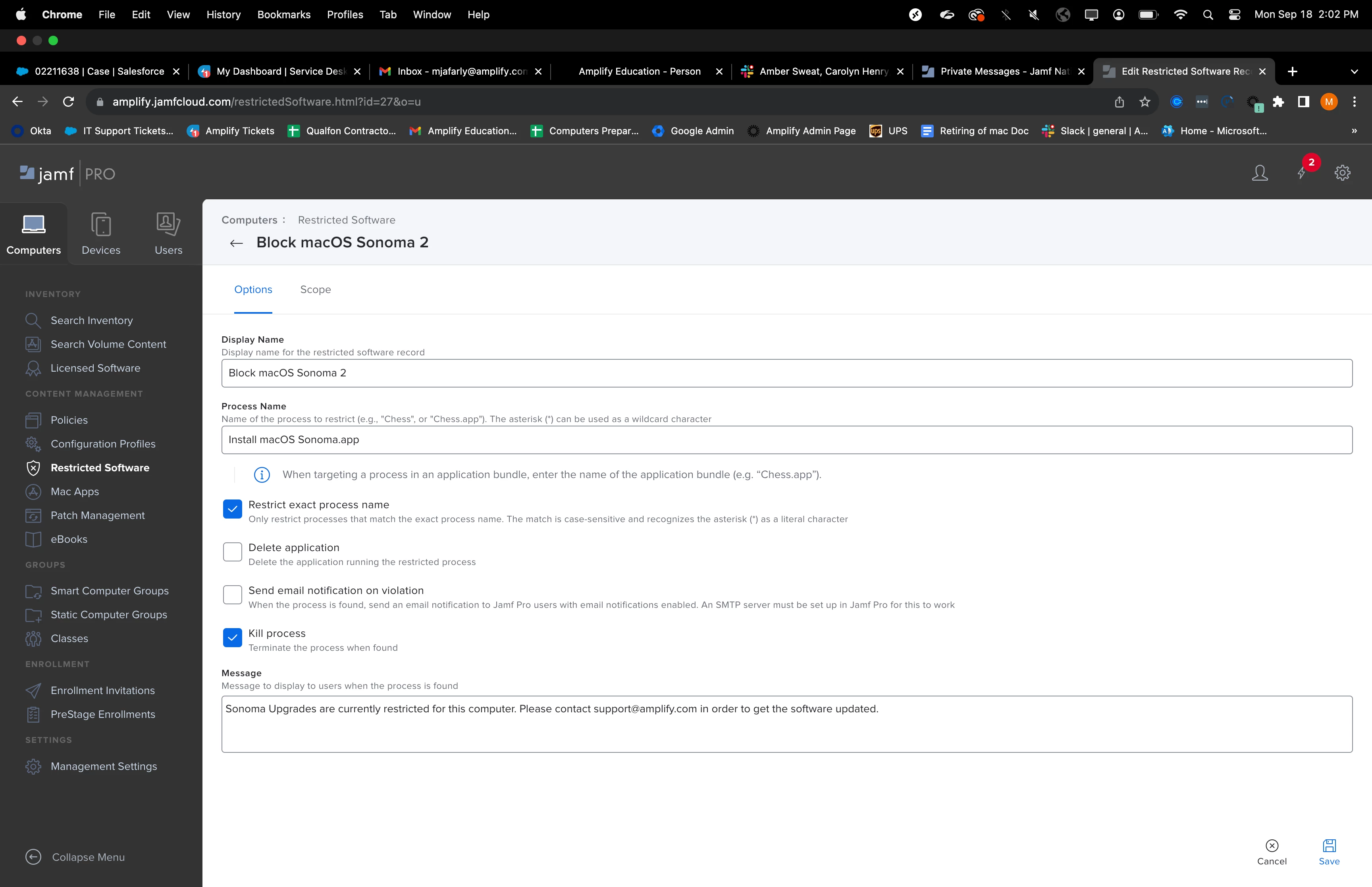

Hello all
I am blocking Macos Sonoma beta with two different restricted software setups, one is Install macOS Sonoma beta.app and the other is "Install macOS 14 beta.app" Im using both just to be safe and make sure I catch the installer .
With the production relase of MacOS Sonoma around the corner I was wondering if anyone has setup their environment to block macos sonoma already. Im looking for the process name
Thank you again

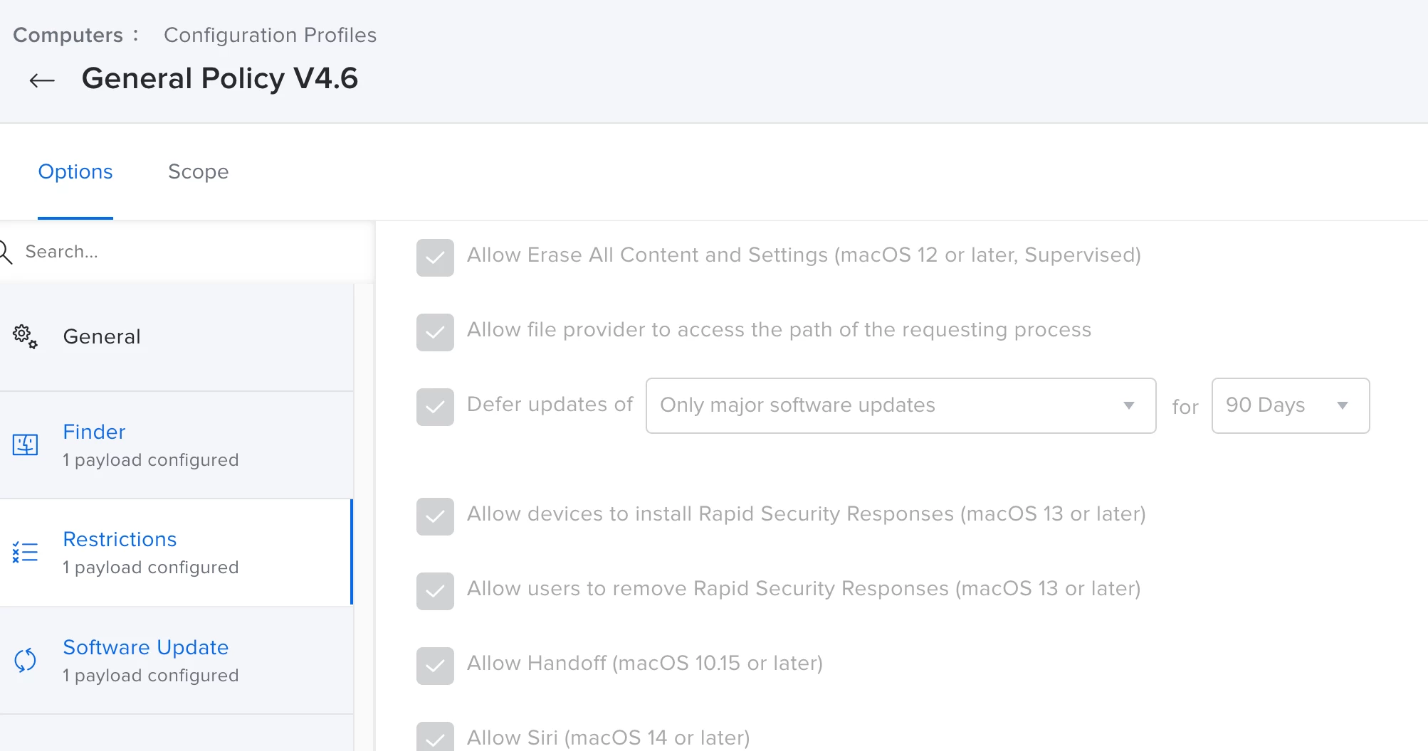

  • Macs running macOS 11.3.1 or newer will not download install macOS Sonoma.app. So, blocking that installer really does not do anything other stopping people who download the app manually, still a good idea to block but wont help much.
  • MacOS 11.3.1 and newer will download Major Software updates as a delta, the ONLY way to block this is with a OS update deferral configuration profile. You cannot defer longer then 90 days.
Deferring Availability of macOS Software Upgrades and Updates with a Configuration Profile - Technical Paper: Deploying macOS Upgrades and Updates with Jamf Pro 10.34.0 or Later | Jamf
  • Sep 14, 2023 12:35 PM UTC
Yea I have my deferral set for 90 days in Jamf already, this is just incase people try and download it in other ways

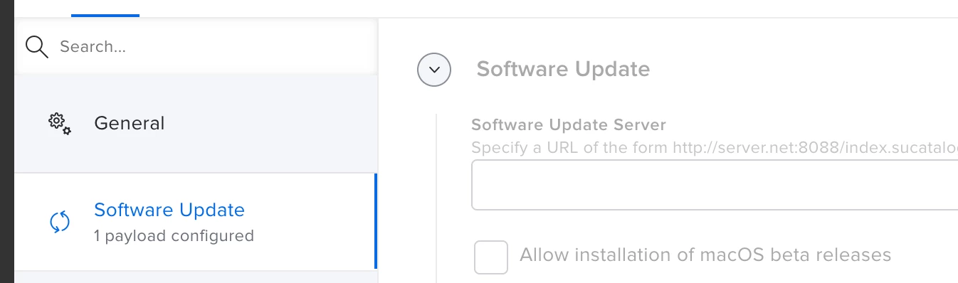

This also is the new way to block folks running the beta OS, as well. Under  your Software Update payload is a check-box to enable/disable installing macOS beta releases. Create one for those who are allowed to pre-test the Software, leave unchecked for all others.
Do i leave the others checked and just uncheck the beta one?
Do you? That's up to you and your team (or teams depending on who all needs to weigh in to provide an answer). I'm going to say yes, you do. Gone are the days of slow-rolling software updates to see if they break things or leaving things mostly in the hands of the End-User to perform. In today's day and age where Macs are as much a target as any other platform, yes, stay current. Do as much of it as you can via automation.

Hello All can i get confirmation if this restricted access i did to kill the mac os sonoma beta will work?
As far as I am aware there is not an install macOS Sonoma Beta.app. Your restriction on install macOS Sonoma.app should work fine, however I strongly suggest testing this yourself. Keep in mind blocking install macOS Sonoma.app wont do anything on Macs running greater then 12.3.1 as they will never download the app to upgrade.

You don't really need a software restriction to block OS betas anyway, it's a simple checkbox available in a configuration profile:

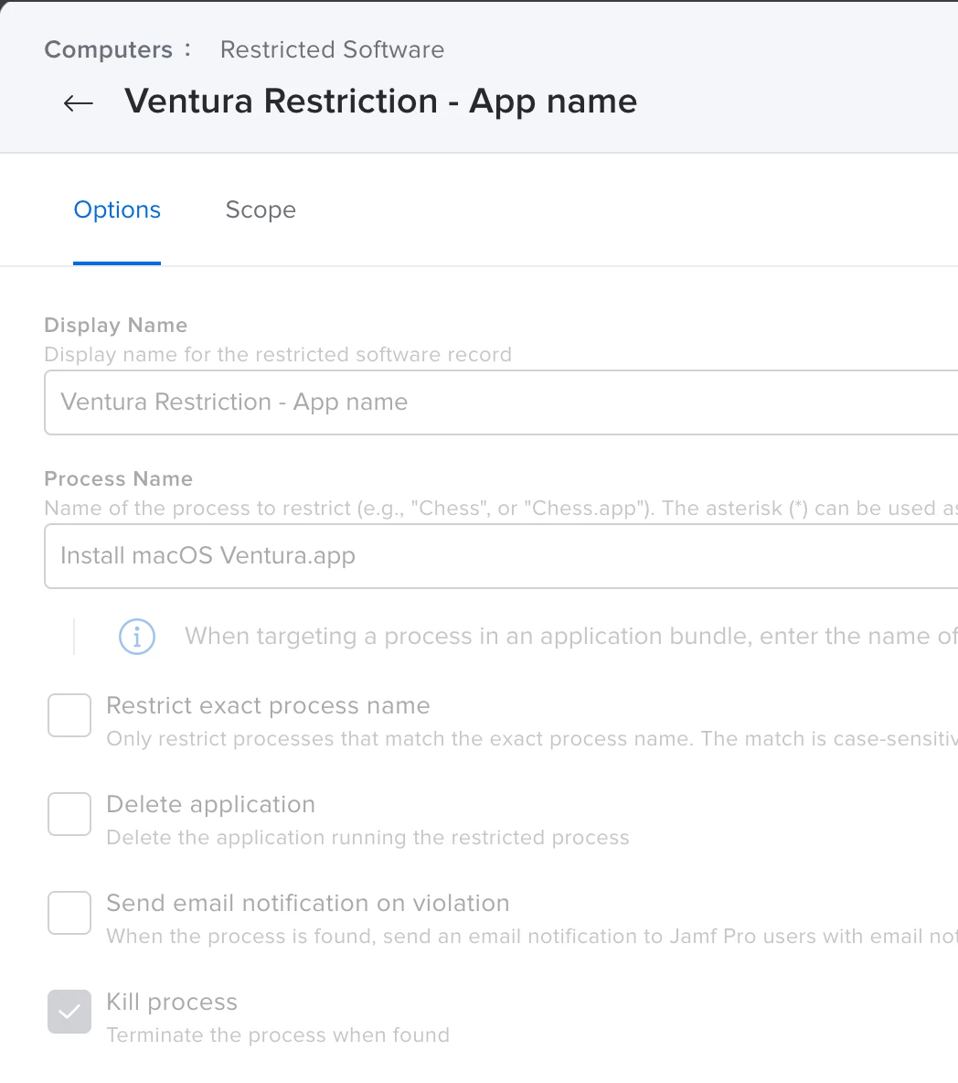

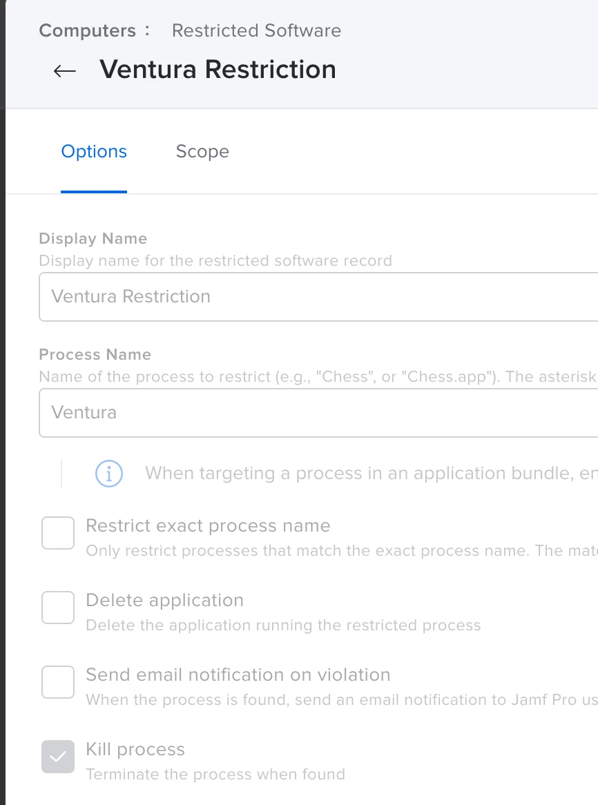

The old-school method to block software updates involved setting Restricted Software process blocks for the software that you wanted to deny. In Ventura's case, it was a combo of blocking the InstallAssistant, Ventura as a process, and I also blocked Install macOS Ventura.app. You can change both scoping and wording to affect different outcomes.  For Sonoma, your process names/app names would just be updated to reflect that. I would feel like the Configuration Profile restriction would be more effective though.

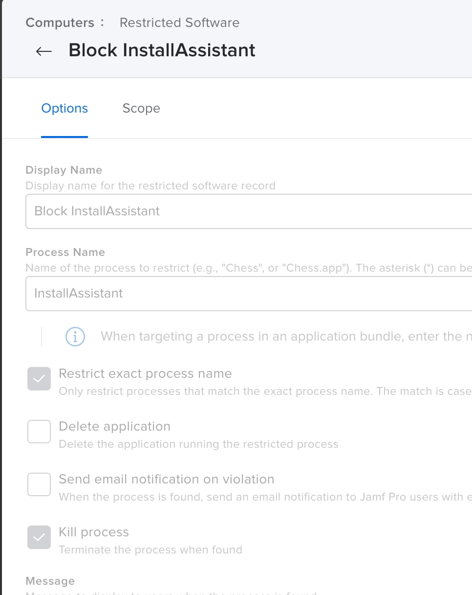

even with restricting install assistant did not work for me, does it work on your end?
  • Sep 27, 2023 1:55 PM UTC
Restricting the Install Assistant did not work on a Test Mac in our Jamf environment either. It would appear the only way to block the install of macOS Sonoma is to use a Configuration Profile to Defer major software updates:
Under Restrictions > Functionality.
As this can only be set for a maximum of 90 days I am looking for a way to extend beyond this time period for further testing. If there is a possible way to do this or put a feature request into Jamf for that would be what we require.
It is not possible, there is no point in submitting a feature request to JAMF as this is Apples intended design. You could submit feedback to Apple, but don't expect them to change anything. All you can do is communicate to users, and hope no one goes rouge.
