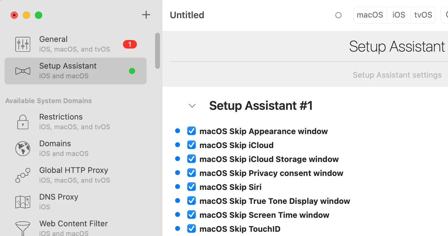

Best answer by KyleEricson
@Levi_
Download iMazing Profile Editor from the Mac app store and use the built-in Skip Setup Assitant payload.
https://apps.apple.com/app/imazing-profile-editor/id1487860882?ls=1&mt=12

KyleEricson
  • Jul 16, 2021 4:13 PM UTC
@Levi_
geoff_widdowson
@Levi_
Hi Kyle,
I've just tried ou this iMazing profile Editor. It didn't skip the Siri setup, but did do the others. I even signed the configuration profile.

Thank you @bartlomiejsojka. I am going to investigate this route for Big Sur and see what happens as this will skip the new account setup specifically.
Hey @KyleEricson, I'm currently skipping all the OOB setup assistant, do you know if the iMazing Editor will conflict with that?
KyleEricson
  • Jul 20, 2021 3:10 AM UTC
No shouldn't be an issue @Levi_
KyleEricson
  • Jul 20, 2021 3:12 AM UTC
Hi Kyle,
I had gotten another one for Siri from Rich Trouton.
https://github.com/kylejericson/JAMF/blob/master/com.apple.SetupAssistant.plist
  • Jul 22, 2021 7:40 PM UTC
@KyleEricson Thank you. When I tried it without signing the profile it failed. Guessing even though the cert is signed by Jamf when deploying it had an issue with it. I signed it and it worked for the next account I tried. I'm going to test it out some more but it seems like this will work so far.
  • Dec 2, 2022 11:50 PM UTC
Hi Kyle,
Hey @geoff_widdowson also for me there is something always there, in my case touchID.
Did you resolve you issue somehow?
  • Dec 2, 2022 11:52 PM UTC
I have the same issue like here, so Accessibility, Data & Privacy, Touch ID & Theme after jamf connect login. I did setup a profile but this doesnt skip TouchID, even I disabled that as well.
Any Idea?
geoff_widdowson
I never got around the issue, just had to live with it.
