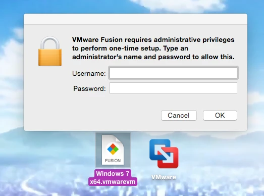

Bypass VMware 8.1.0 one-time setup administrator privelages.
  • Jan 15, 2016 2:31 AM UTC
  • 13 replies
  • 255 views
I have already installed the vmware pkg with the windows file, but when I try to open it, it gives me the message: "VMware Fusion requires administrative privileges to perform one-time setup." Is there any way to install VMware without using any admin privileges?

I'm not on 8.1 yet (still 8.0), but I run this after install (with Casper, as root) and users are not prompted for administrative privileges:
/Applications/VMware Fusion.app/Contents/Library/Initialize VMware Fusion.tool set
Just wanted to say THANK YOU. I know this thread is like 6 years old, but i have been struggling with patching Fusion and getting around the admin prompt on first launch as all of our users do not have admin rights. This worked perfect with Fusion 12.2.3.
  • Oct 24, 2023 7:28 PM UTC
Tested with VMware Fusion 13 and confirmed this works still. Thank you all!
