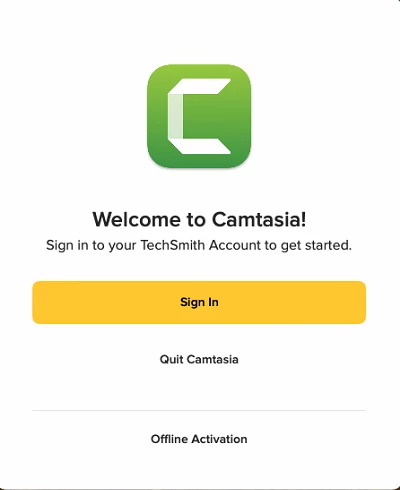

I have been trying to get Camtasia 2023 to install with JAMF for 2 weeks solid. I am following their Enterprise guide Enterprise Install Guidelines For Camtasia on macOS and I am not getting any luck. I have followed all the steps in creating the LicenseKey file, put into the proper location, and gone so far as to package that separately and deployed that and the Camtasia package (downloaded from the AutoPKG app). Camtasia installs fine, but upon launch, it does not grab the License information.
The next issue (which I know is moot until I can solve the first issue) is I would like to utilize all of the "Deployment Options" that are listed on the document above. When I try to do just the one where the software doesn't display the sign-in page, the software cannot see the app license anymore as a valid license. I don't understand why that is.
What makes these options difficult is that the plist that they write to isn't created until after the software is launched for the first time (the plist is created in the users preferences folder, not the global library preferences). It appears to me that Camtasia isn't really designed for a multi-user environment. I'm totally at a loss on what to do. Please help!

Nope, I am still stuck. Your experience is exactly like mine. I reached out to TechSmith support and they say follow the guide. When I told them it doesn't work, they literally said, "Sorry..." and offered nothing else for support.

For what it's worth I was having endless issues getting this to work until I double checked the formatting of the LicenseKey file and placed it here:  /Users/Shared/TechSmith/Camtasia/LicenseKey
On Sonoma I had to open TextEdit - Settings:
Under New Document - Change it to Plain Text.
Under Open and Save - Unchecked the add .txt to end of file option and saving as plain text default to UTF-8 Unicode. Not sure if needed but I also unchecked the preserve whitespace option.
When saving the file it should say Plain Text Encoding at the bottom with UTF-8 already selected.
After packaging this in composer and sending it out as part of the install the text file showed up as a unix executable file but this did not stop Camtasia from opening it and licensing the application.

@b_rant I have tried the method above countless times, but when I open the application I get prompted with this:
I am not sure what I am missing. The license file is formatted as you mentioned above. I have packaged the application with the license file and folder structure, and have also tried packaging the application and the folder structure separately. I have also tried the process locally, with no luck. Any insights on how you got yours to work are appreciated.
Something else that seems to work is to copy a current unix executable file and then edit it with the license key info and rename it. Did this for the 2024 update instead of making a text file.
This would look something like this:
Open Finder - Go - Go to folder - Type /bin
Copy any Unix Executable file from here to /Users/Shared/TechSmith/Camtasia Folder
Rename the file inside Camtasia Folder to LicenseKey
Open LicenseKey file in TextEdit and delete everything here, replace with only the License Key Number
Throw this into Composer and make sure to fix the owner to root/wheel . (I have my permissions set to 777 but not sure if this is really needed, read may be enough.)
Deploy to your test machine and it should open past the sign in screen.
