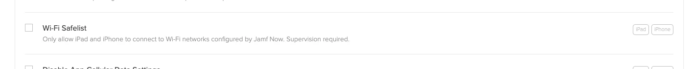

what’s up with this?
In any event. To answer your question, I am going to wager you don't have the blueprint setup correctly. The device needs to be supervised, and you use the Wi-Fi Safest payload. On a supervised device, with this payload deployed in a Blueprint, it will restrict the WiFi networks to only MDM configured networks.
