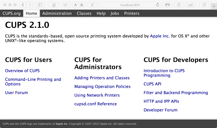

It's been quite some time since I've done this but if I remember right, as long as I've entered the following at the terminal, I should be able to access localhost:631
cupsctl WebInterface=Yes
Instead I'm getting a message that I can't connect to the server. Ideas? This is on 10.11.6.

Did you run cupsctl with sudo?
I show it to be working here from 10.11.6

Yep still works for me with sudo on 10.11.6.
  • August 26, 2016
@SGill Yes, I did use sudo. I tried it from another system and it worked like expected so for some reason it's broke on my own system. If someone has some ideas as to how to troubleshoot and address it, I'm all ears.
  • August 26, 2016
Does this command fail for you on that workstation, too?:
sudo launchctl start org.cups.cupsd
  • August 26, 2016
Are there any proxy servers involved on the system that's not working?
Also to rule out any networking related issues, it's possible that the machine could be trying to resolve that URL to an actual address, try disconnecting the machine from any ethernet connections and turning off wifi. Then try to load the cups web interface again.
We used to have this issue all the time with out network proxy servers and when Apple pointed you to 127.0.0.1:631.
Adding a line to bypass it in the proxy settings took care of it.
