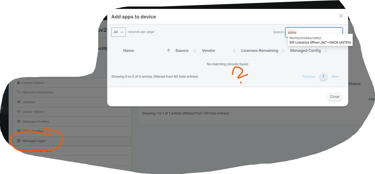

Hi,
I have a teacher who's using SONY headphones, so i wanted to push him the sony app.
The purchased app is properly synced from ASM/VPP Store to JAMF.
But when i load the device in JAMF school and want to "add" the app to the device, the app isnt not listed.
But i can see the app under JAMF-Apps.
What cant prevent an app to show up .

Have you tried creating a device group for just that app and placing the teacher device into that device group? It's a work-around to get an app pushed to a specific device.
I'm guessing that you have the app and the device in the same location. We use multiple locations for our schools and that makes a difference for apps being purchased and pushed. Have you scrolled through the list of available apps instead of using the search? Not sure if it would matter, but maybe a localization/language spelling difference?
That's all I can think of at the moment to try.
Good Luck!

Apps don't show up if they are not compatible with the device.
In this case I think you want to install "Sony | Headphones connect" on a iPad. This app is only compatible with iPhone/iPod Touch.
