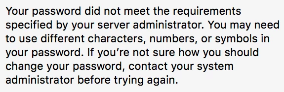

Has anyone experienced any issues resetting (AD) passwords on a Mac? In AD I select an account and set, “User must change password at next login”, I attempt to login as that user and am prompted to change the password, but all password entered are rejected with: Your password does not meet the requirements of the server.”
The password policy is set to 8 characters and that’s it. This same user will have no issue resetting in Windows. I will also receive the same error when attempting to reset from Users & Groups in System Preferences.

Is the account expired? Have you tried changing the password too many times within the directory's allowed window? Sometimes if you change it too much you have to wait an hour (or more, sometimes 24 hours) to change it again.

what do you get from the command kpasswd in terminal ?

@rwinfie I get, "Soft error : "
  • Mar 6, 2017 9:10 PM UTC
ok , two more test i would run , is the command id with a know good account and dsconfigad -show , this seems to be a bad AD connection currently ( which you already knew ) but these two commands will show if it is at least talking to the domain properly.

We have a 3-day password change cooldown in AD. If the password has been changed by any source (the user themselves or an admin user with ADUC, for example) then the user cannot change it again themselves for 3 days. It gives the same error message about not meeting requirements.

I modified the local computer policy on the DC and that appears to have fixed this test client. I'm not sure why it worked within Windows? Maybe the windows machine was hitting a different DC? Looks like I have a bit more testing to do.

We face similar issues. Our users must choose new passwords every 30days. Complexity defined on AD is 6-8 characters and at least one number, no special characters (our mainframe doesn't like those).
Every now and then users get the message on mac their password does not meet complexity. But it does.
And on AD the password gets changed. User must then reboot the mac in order to logon to the account (sometimes with keychain issues as a consequence).

We had this issue too. The fix we found to work was verifying that Mac's time is the same as the Domain Controller. If the time is off by more than five minutes, it wouldn't let you change your password. Go into System Preferences > Date & Time and fix the time.

my simplest solution is change the password once when asked by the expired procedure during login (you will get the complexity error)
just click cancel ( as mentioned AD actually accepted the password change) login again with the new password, and you'll get in (of course there will be the issue with keychain - couldn't figure that one out, as my users keep getting many pop ups of the what seems to be the same keychain..)

I'm sure this isn't the case with everyone else but wanted to throw this in just in case someone is having a related issue with this error message as it had nothing to do with a password requirement (letters, numbers, etc...). The problem could be because your AD environment is set to not allow users to change their password after X number of days. Check the "Minimum password age" in Group Policy.
When you try to use "kpasswd" in Terminal we got the message "Soft error :".
This error kept appearing for us after a user changes their password and then tries to change it again in System Preferences > Users & Groups.
Come to find out we have the "Minimum password age" set in Group Policy. We waited the minimum days and the password change went through successfully.
