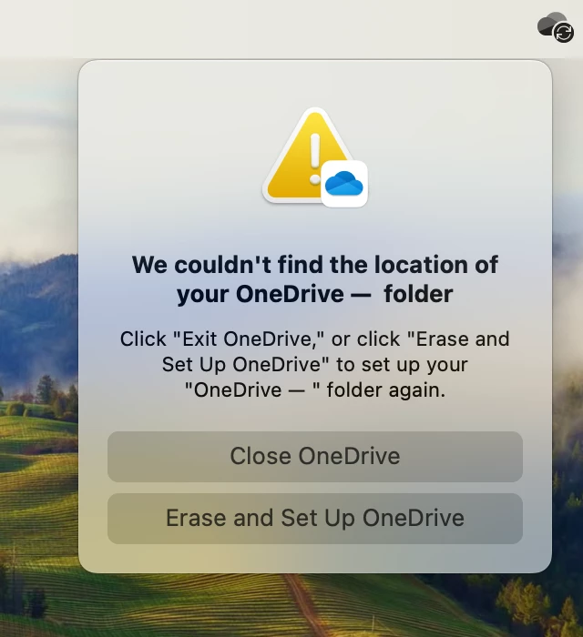

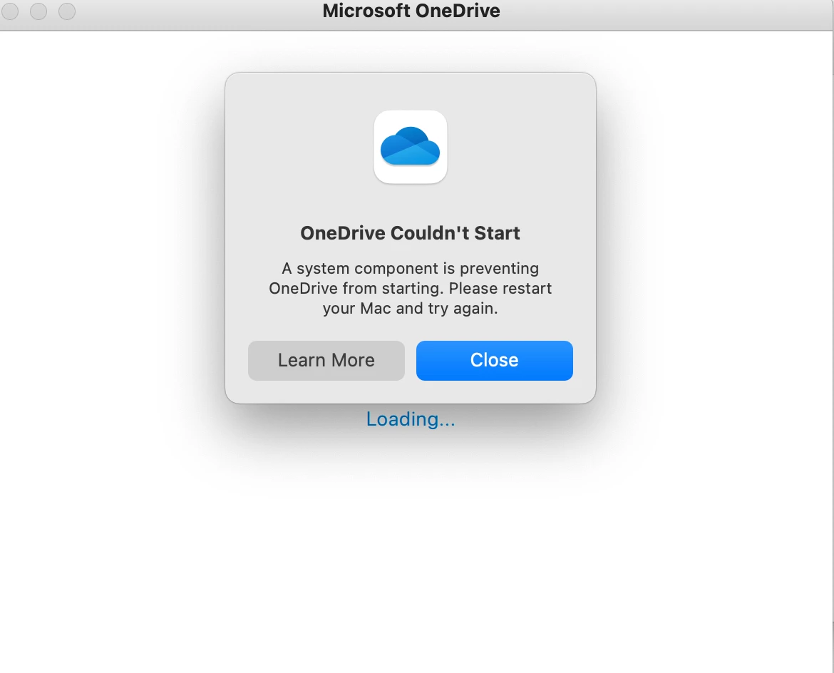

Hey so we use Jamf to deploy our Macs and recently whether it's a new Mac or one that's been wiped, we're unable to open and start OneDrive. Tried everything from uninstalling and installing from O365, installing from the microsoft page and so on. When running Onedrive I get an error saying Onedrive Couldn't Start, a system component is preventing OneDrive from starting. If I quit from Onedrive and try to start it again the error become We couldn't find the location of your onedrive folder, and the cycle repeats itself. Only thing I can find on the internet is involving Files on Demand.

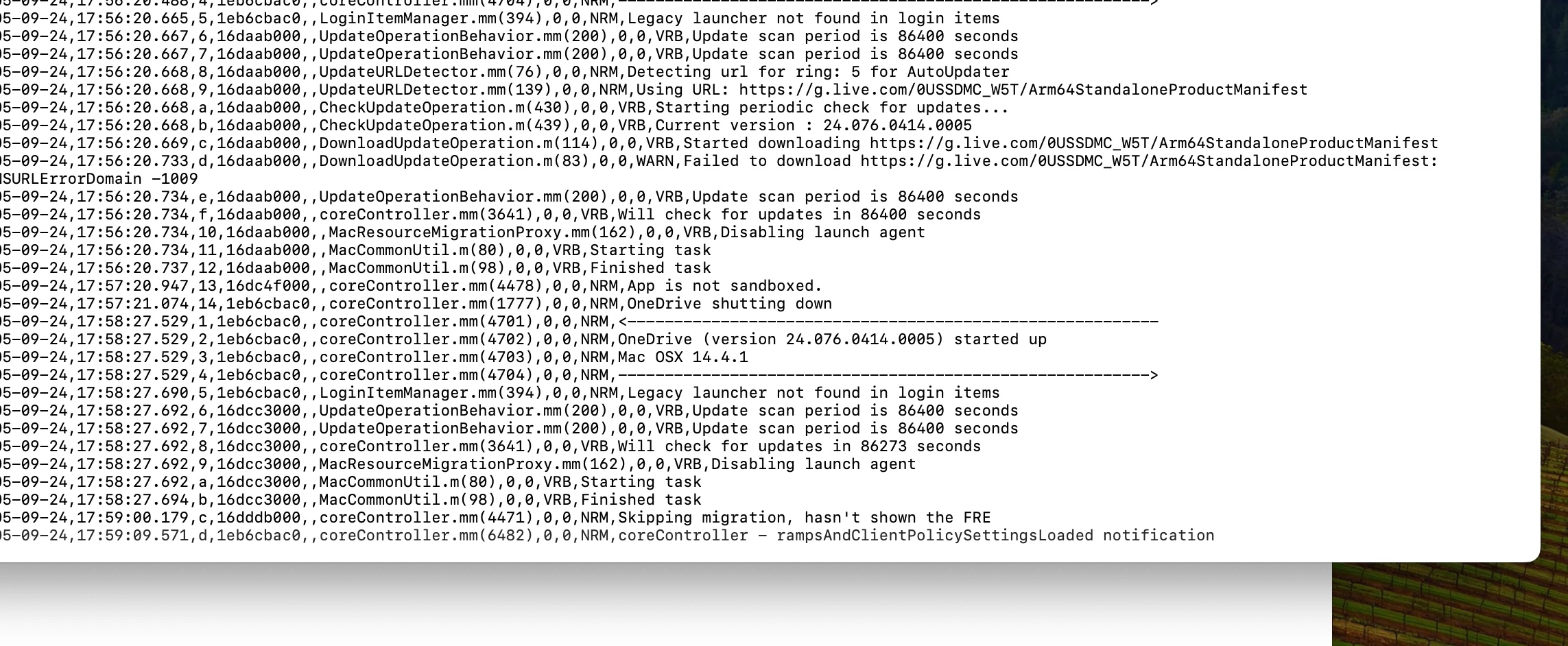

@AJPinto i shared my console logs of what I see when i try to open OneDrive and sign in.  I only get this when OneDrive error of OneDrive couldn't load.
