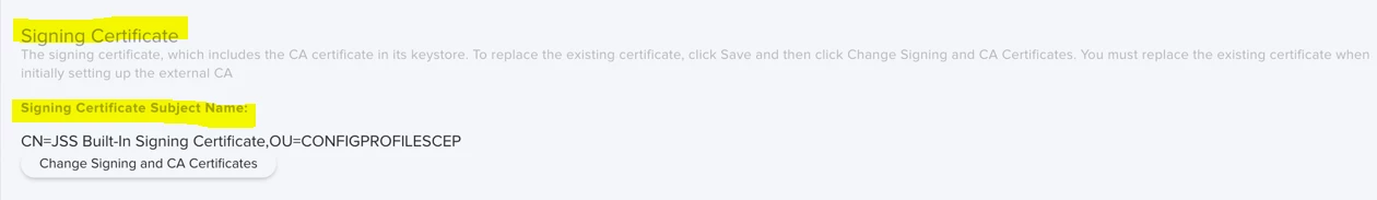

@Ferri @sdagley  We have the External CA  setup to enable Jamf pro  as SCEP proxy for configuration profiles . Wanted to know if certificate uploaded on signing certificate option is  valid or not , dont have any option to view it
