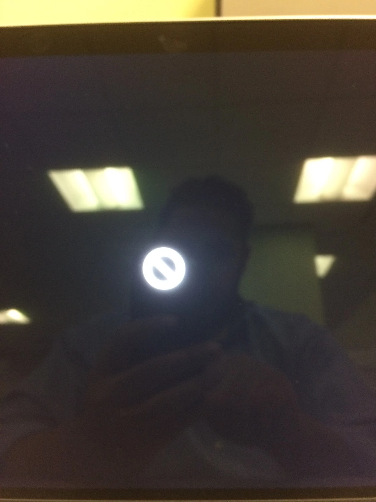

I have updated our NBI using AutoCasper NBI 1.3.4 using a base OS of 10.12.2 (16A323) and Casper Imaging 9.81. When I attempt to boot from the NBI it just comes up with a prohibitory symbol.
Is there something I might be missing here as to why this won't Netboot?
Just in case I am using a startech US1GC30W USB-C to Gigabit Network Adapter. Can anyone provide me some tips on what I should look for?
Thank you
Best answer by mpermann
@mrperrott I know my 13" Touchbar MacBook Pro NetBoots fine using an NBI with macOS 10.12.3 created with AutoCasperNBI. Maybe that 10.12.2 build isn't a supported build. Can you recreate your NBI with 10.12.3 and repeat the test?

Use a base OS of 10.12.3.
done.

As soon I used a 10.12.3 base image the device Netbooted with no issue.

Just chiming in with 10.12.4 update: bag of hurt with Touchbar macs.
2016 MacBook Pro with TouchBar
10.12.4 AutoCasperNBI on USB - boots
10.12.4 AutoCasperNBI on Netboot - no joy.
The EFI is the most likely cause:
http://blog.eriknicolasgomez.com/2016/11/27/the-untouchables-apples-new-os-activation-for-touch-bar-macbook-pros/
I tried a little hocus pocus: created AutoCasperNBI, restore to USB, used Apple System Imaging utility to make a Netboot (in the hope EFI partition magic would occur)... while the kernelcache did change it was still no go using Apple's own tools to make a Netboot.
So I am almost giving up on that, 10.124. Netboot works for other models, but not the newest... so USB sticks for the techs right now... perhaps Apple will update System Imaging Utility or given enough hours in the day, make some über NetBoot dmg with an EFI partition that has the firmwares in it... but that is not sustainable. Netboot's beauty was supposed to be build once and run for all models.

I just received a 15" TB MBP preloaded with 10.12.3 from the factory... (Of course it was a forked OS)
Upon upgrading to 10.12.4 (to try and unify the OS), and creating my NBI with System Image Utility, the MBP will initially start the boot process from my Netboot server (show the globe), but will then show the no boot symbol alike in the first post.

Created netboot with 10.12.5 and no luck. Getting circle with line through it when netbooting.
