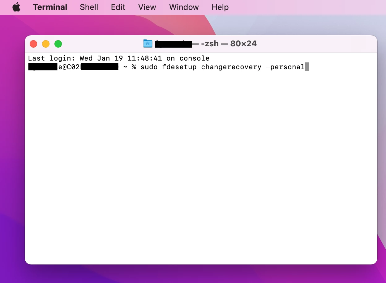

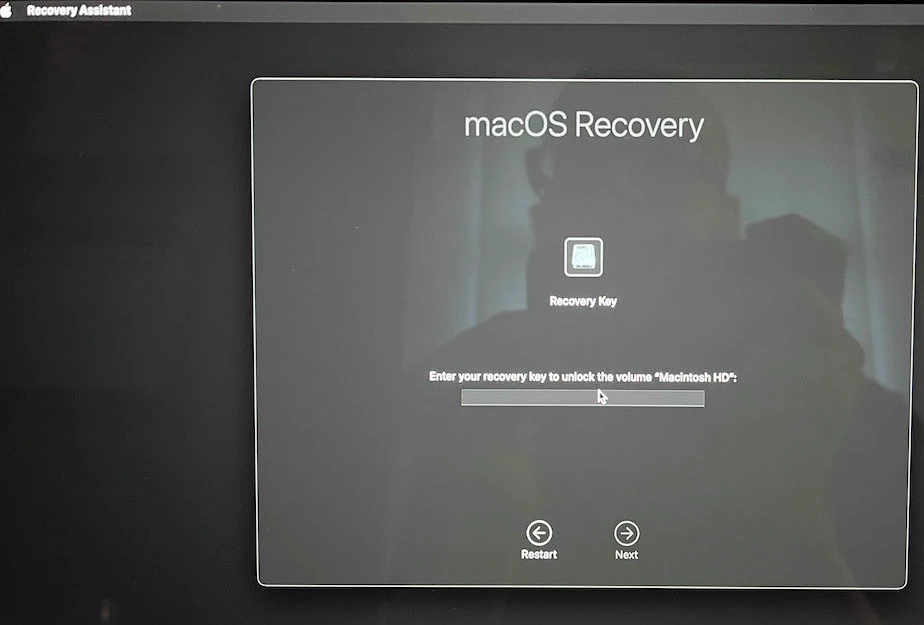

One thing I did find afterwards for one case I did was that when I tried to re-enable SIP I encountered an issue where it asked for the Recovery Key at Recovery Mode instead of presenting accounts that can unlock the drive.
In my case this Mac, apart from having trouble processing MDM commands, had also not escrowed the Recovery Key in Jamf so I had no recovery key to enter. I had to reboot back into normal mode and create a new recovery key plus reboot a couple of times so that I could enter the recovery key it was asking for.
Creating a new recovery key:
sudo fdesetup changerecovery -personal
  • Jan 20, 2022 4:42 PM UTC

Oh, sorry I should have specified that I did have to work through something as I got a similar error.
You'll need to do a sudo -s first as I don't think it can find matches due to permissions since the account is not elevated yet (even if you put sudo in front of rm):
So basically
sudo -s /bin/rm -rf /var/db/ConfigurationProfiles/Store/*

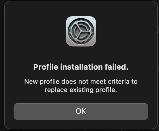

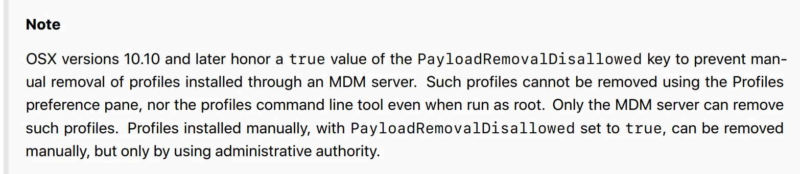

Question on this.  If I have created profiles using Configurator or Imazing for Macs and had the
"PayloadRemovalDisallowed" set to true and pushed the profile out with Jamf.  Can I still remove it with Jamf?  Not using DEP.   I assumed the PayloadRemovalDisallowed was only for users to not remove the profile locally.   thanks
aledesma
  • Jul 12, 2023 2:45 PM UTC
If your "PayloadRemovalDisallowed" profile is visible in your Jamf menu, you can certainly remove it with Jamf.
Jamf's documentation states that:

  • Jul 12, 2023 4:57 PM UTC
Do you know if you can overwrite that profile?  If the profile is modified and pushed out, will it overwrite the existing?  I have same question.  Inherited a Jamf project and want to modify some profiles already out there.  I just want to push them out again and go over the existing since same IDs instead of removing and them pushing out again.
