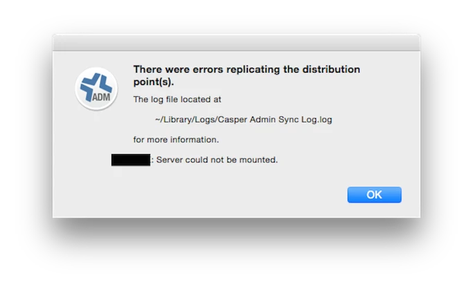

Hey guys,
Ive been wrestling with this one for awhile. We just moved from 9.63 to 9.72, and ever since then have been unable to replicate to our other share via Casper Admin. It just cant mount the share. Its been working(for the most part) since we stood up everything but now fails consistently.

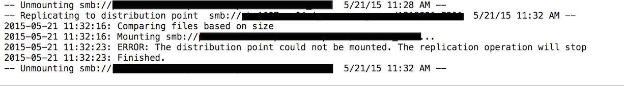

The error I get is this, and when I check the logs in the location specified, you can see there really isn't anything helpful to troubleshoot the problem.
The strange part is that, it IS actually mounting the share! I verified this by running a "df" command from terminal I can see the share is indeed actually mounted. Ive tried unmounting, restarting, re-adding it, checking the read/write accounts, resetting passwords, and a host of other recommendations on different forums here on JAMF nation but none have been successful.
The other odd thing is this will even happen with the master distribution point time to time for no reason I can plainly see. I usually will have to close and reopen Admin a few times, and unmount the share manually before it will work again.
This has happened in the past intermittently, but now, it seems to have become a constant and Im running out of ideas. Figured I'd see if anyone else is having issues like this or maybe some recommendations?
