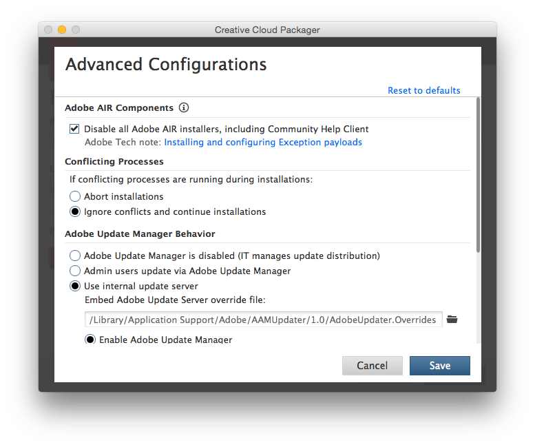

When you used CCP to build it, did you choose the options to:
Disable all Adobe AIR installers, including Community Help Client
Ignore conflicts and continue installations
If not, that's your issue (AIR will hang a machine if install is attempted at imaging time).

The suite was package by our last Mac person. Since that person never used Casper I feel like it was packaged wrong. I'll need to find/request/buy Adobe CC packager and re-do this. Thank you once again @RobertHammen. I'll update this thread once that process is complete.
