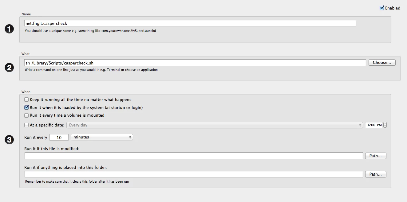

Hello and help.
I have been messing with this for days to no avail.
I implemented CasperCheck months ago, yet come to find out it only works when a Mac reboots, not at the specified interval. So I could have Macs not checking in that have not been rebooted.
So I researched and came here, and as echoed here, permissions issues.
Went to a brand new imaged test machine, and after setting permissions properly on both caspercheck.sh and com.companyname.caspercheck.plist, I got it to load by running:
launchctl load /Library/LaunchDaemons/com.companyname.caspercheck.plist.
I actually changed this plist to net.companyname.caspercheck.plist,so it is easer to spot in launchctl list
And it works. I specified a new interval, 10 minutes (600) seconds, and every 600 seconds caspercheck.sh runs.
I can see this in Console, /var/log caspercheck.log
The issue is, I have to load the plist with the load command, so I was thinking in Composer, use a post-install script command with the launchctl load /Library/LaunchDaemons/com.companyname.caspercheck.plist.
Haven't even got that far in Composer though.
Once the plist is loaded, it's loaded, Until....
On either reboot or login, the plist won't load. I have to manually load it.
Something is up.
Thx in advance,
john

@johnklimeck,
You mentioned you edited the LaunchDaemon file. Would you please post it somewhere that I can take a look at it?
rtrouton,
Sure thing, here it is:
<?xml version="1.0" encoding="UTF-8"?> <!DOCTYPE plist PUBLIC "-//Apple//DTD PLIST 1.0//EN" "http://www.apple.com/DTDs/PropertyList-1.0.dtd"> <plist version="1.0"> <dict> <key>Label</key> <string>net.fngit.caspercheck</string> <key>ProgramArguments</key> <array> <string>sh</string> <string>/Library/Scripts/caspercheck.sh</string> </array> <key>RunAtLoad</key> <true/> <key>StartInterval</key> <integer>600</integer> </dict> </plist>
The same behavior occurs with the com.fngit.caspercheck.plist
I was going to go back to your original files, and test again. See what happens. Thx
Forum|alt.badge.img+33
The launchdaemon file looks like it's OK and Lingon's not tossing up any flags.
Is the file named net.fngit.caspercheck.plist and is it stored in /Library/LaunchDaemons?
Yes, that is it.
I guess the question is, why is this plist not loading automatically.
I think this could still be a permissions issue?
ls -l total 48 -rw-r--r-- 1 root wheel 462 Aug 26 07:28 com.adobe.fpsaud.plist -rw-r--r-- 1 root wheel 737 Sep 22 13:42 com.jamfsoftware.jamf.daemon.plist -rwxr--r-- 1 root wheel 474 Sep 22 13:42 com.jamfsoftware.startupItem.plist -rw-r--r-- 1 root admin 528 Sep 22 13:42 com.jamfsoftware.task.1.plist lrwxr-xr-x 1 root wheel 103 Sep 22 13:47 com.oracle.java.Helper-Tool.plist -> /Library/Internet Plug-Ins/JavaAppletPlugin.plugin/Contents/Resources/com.oracle.java.Helper-Tool.plist -rw-r--r--@ 1 root wheel 448 Sep 22 13:54 net.fngit.caspercheck.plist FNG143301:LaunchDaemons foxadmin$ cd /Library/Scripts FNG143301:Scripts foxadmin$ ls -l total 24 drwxr-xr-x 10 root wheel 340 Sep 9 2014 ColorSync drwxr-xr-x 15 root wheel 510 Sep 9 2014 Folder Action Scripts drwxr-xr-x 7 root wheel 238 Aug 13 11:53 Folder Actions drwxr-xr-x 7 root wheel 238 May 10 19:00 Font Book drwxr-xr-x 8 root wheel 272 Jan 22 2015 Printing Scripts drwxr-xr-x 14 root wheel 476 Sep 9 2014 Script Editor Scripts drwxr-xr-x 7 root wheel 238 Sep 9 2014 UI Element Scripts drwxr-xr-x 5 root wheel 170 Aug 13 11:50 VoiceOver -rwxr-xr-x@ 1 root wheel 11954 Sep 22 14:00 caspercheck.sh FNG143301:Scripts foxadmin$
