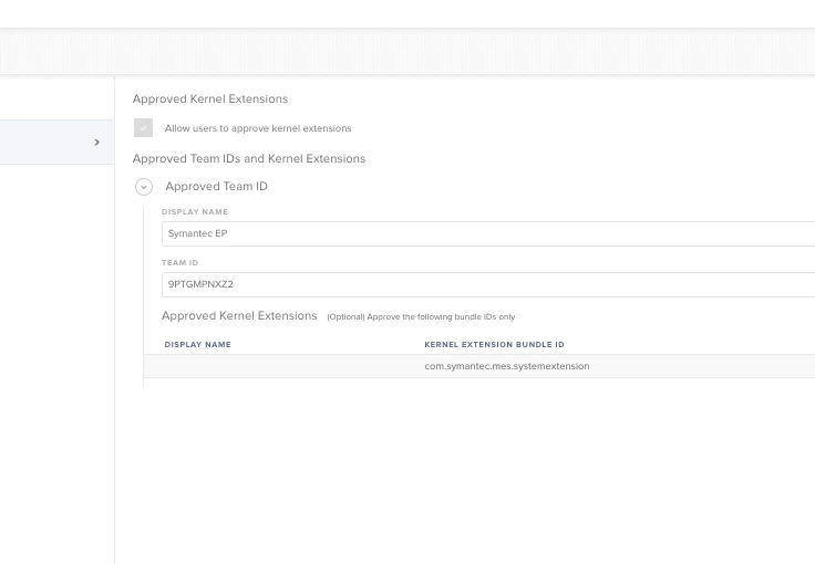

Forum|alt.badge.img+20
  • January 27, 2020
@rqomsiya did i edit this correctly? looks different than yours. maybe because of version

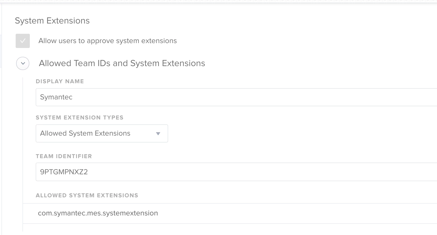

@gachowski looks like i got it to work by using the 3 payloads.
1 - PPPC
2 - Approved Kernel Extensions -----> did not enter any kernel extension bundle IDs, just entered the Team ID
3 - System Extensions

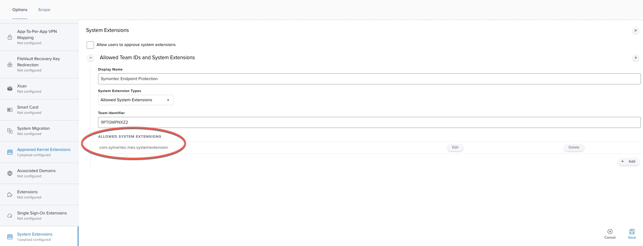

  • August 25, 2020
Adding com.symantec.mes.systemextension in the allowed system extensions field seems to have fixed my issue.
